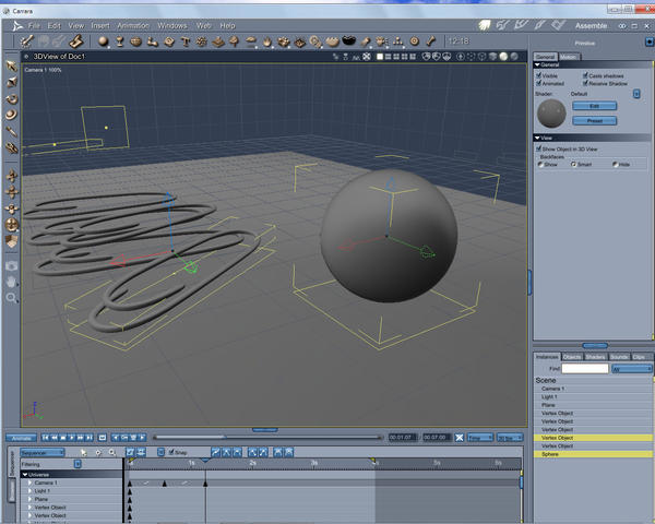

If you look closely at a simple Bullet physics sim of a sphere bouncing on a plane, you'll notice that there can be an Offset, or Gap, between the actual sphere geometry and the Collision / bounce (see pic)

You're right, the collision spacing is adjustable now, but even at it's lowest level, it's still using a simplification rather than actual mesh on mesh collision. mostly because it's faster to calculate, although it can be less accurate.
