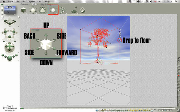

  • Dave SavageDave Savage Posts: 2,433
    Select the tree (or whatever object you want to move).
    Click the 'edit' tab to bring up the icons show below in the screen grab.
    Chose the control icon I've highlighted with a red square.
    Clicking on the extended arrows and dragging the mouse will move the selected object in the directions shown*
    * The left/right, back/forward will depend on how your camera is set in regard to North, South, East, West, Sometimes you will have to drag the left arrow to make the object move right etc. which can be little confusing until you get used to it.
    You can also select an oject and move it back, forward, left and right using the arrow buttons on your keyboard. Each click will move the object a set number of Bryce units. If you want to move it in finer increments, use the 'option' modifier in conjunction with the arrow buttons on your keyboard.
    I have also ringed the 'drop to floor' arrow in the mini menu at the side of any selected object.
    You will find that 'drop to floor' will need further adjustment with trees as they have to go beneath the ground.
    1280 x 800 - 323K
