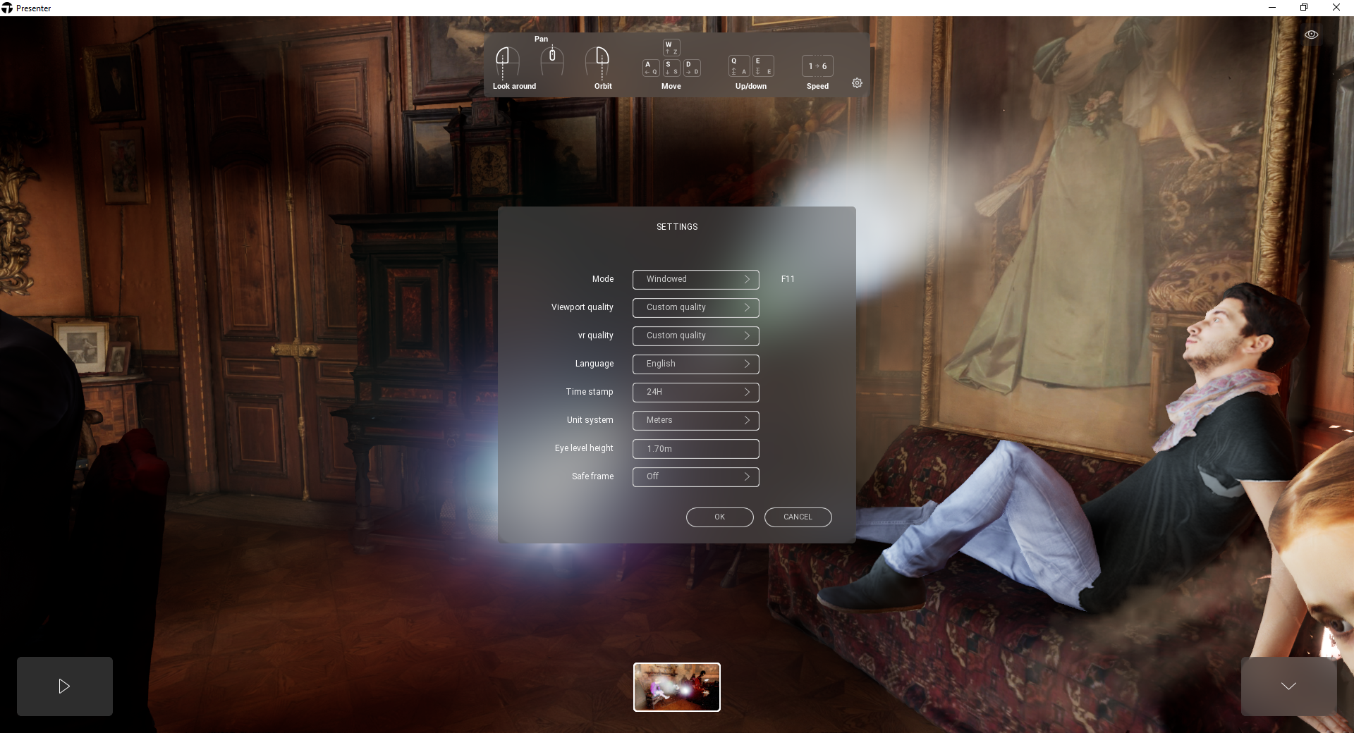

  • WendyLuvsCatzWendyLuvsCatz Posts: 41,845
    I have no idea if this is a Gaussian Splat
    it likely was at some point though
    captured using Windows game capture but of course I can render it in Lumen or Path Tracing if so inclined
    it plays like a game with WASD controls (and footstep sound) or flying camera
    basically like a game made with Unreal Engine but much faster and easier
    I am trying to export that scene in my video now to demonstrate as it's CC by Atribution
  • DiasporaDiaspora Posts: 555
    I really need to look into that cause gaussian splats are really interesting but maybe I get the best bang for my buck, so to speak, by just having the models themselves in the scene.
    edited August 30
    I can't walk around this one, it's too small blush
    and footsteps are not sounding (this is a later version of TM than I used before).
    anyway. it has all the menu options including connecting a VR headset which I don't have
    just compressing a zip for you to put on Google Drive
    is 5.32GB so slow to upload for me, looking like 2 hours!
    will link when done, will delete after a week because that's more than a third of my free space!

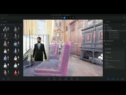

    https://drive.google.com/file/d/1LRw7qFobvGddPFj0sA7M9qOaETQtKuJW/view?usp=sharing
    link for Presenter example

    @Wendy:
    Just watched your presenter and WOW! That was amazing, had to turn the speed way down so that I wouldn't fly through the room but that is really cool and I'm really eager to start cooking up my own stuff in Twinmotion. (Still gonna look at Gaussian Splatting but it's good to have options!)
    I obviously have a lot of my own homework to do but if you don't mind a few questions that I hope have relatively simple answers, I've already started dabbling, I did an FBX Export like I saw you write about elsewhere and got one of my own animations to play in Twinmotion! Yay
    1: The clothes and hair of my character were just in a T-Pose and not being animated, is there just some box I forgot to check somewhere?
    2: On the flipside, the clothes did have textures from Daz Studio but the character didn't have their skin texture come over? Is that another checkbox or is it a much more involved operation?
    3: Is there any way you know of to get D-Former deformations to make it into Twinmotion or alternately the D-formers could be baked as per frame morphs?
    Thanks again for helping to guide me to this point.
    merge skeletons in DAZ export for your hair and clothing to follow
    I myself avoid all the map exports by using a much older version of TM that uses original paths but that may not be available to you
    it does mean everything is locked to this computer and drive setup though but there is always the option to collect textures afterwards in Twinmotion
    one can sort materials alphabeticaly and drag the first identical one onto the next ones to consolidate and reduce the number of materials but make sure they can be, because going back is impossible after saving a scene and means reimporting
    also annoyingly especially for buildings, none are 2 sided (Unreal does this too) so you need to check that under miscellaneous on every one
    don't use animated for static objects either only rigged animated figures
    bring animated objects in as one mesh, static sets keep hierarchy
    probably much more to ask but I thought of the ones that annoy me devil

    Blendshapes (morphs) could still come, Unreal updates their stuff often
    or more likely Alembic ,abc a mesh cache format increasingly popular and grooms for hair
    if it does, Sagan is the DAZ plugin you need

    "I did say only bone animations are supported "
    Oh... that's quite a substantial limitation.
    I will look into the Blendshapes to bones thing but shoot, this would actually represent quite a wall of how far I can expect to go. Aaaah, this is why I was kinda hoping this Gaussian Splats thing would work out cause in those cases, I don't need to worry about how any of this rigging stuff can make it between different software platforms.
    https://dev.epicgames.com/documentation/twinmotion/animation-overview?lang=en-US
    "Twinmotion does not support"
    "Any kind of point-level animation, including but not limited to morph targets and blend shapes."
    Yep, explicit confirmation. It would be incredibly convenient if they added in support in the next few months but I don't see a twinmotion roadmap anywhere so I don't think I should bank on that.
    Ok, well, I guess I'll sleep on it and think on what's possible in the future.
    if it does, Sagan is the DAZ plugin you need"
    Thank you for the lead! Really hope Epic adds this cause it sounds like this would address most of my concerns.

    "there is always Unreal Engine enlightened"
    True, I guess I just need to figure out how I turn an FBX I pull out of Daz Studio into something like what twinmotion does with presentations that I can then distribute to others, I have no idea how to do that with Unreal but I'm gonna try to figure out how.
    Sidenote, I looked into it and Twinmotion documentation doesn't make any mention of animated point clouds anywhere, from what I'm reading I should just assume that animated Gaussian Splats in Twinmotion are a dead end as well. And yeah, from what I'm reading, architecture is Twinmotion's main focus so that will guide their priorities and be the reason why Vertex Animation support has been only under consideration for almost 3 years now.
    Yeah, I guess Unreal Engine directly is my best bet cause it would be one thing if Vertex Animation was in progress already but it might be multiple years if ever this feature gets applied.
    So at this point if I could ask one more thing, can you point me to any documentation on Blendshapes to Bones? I haven't been able to find any mention of it about Blender.
