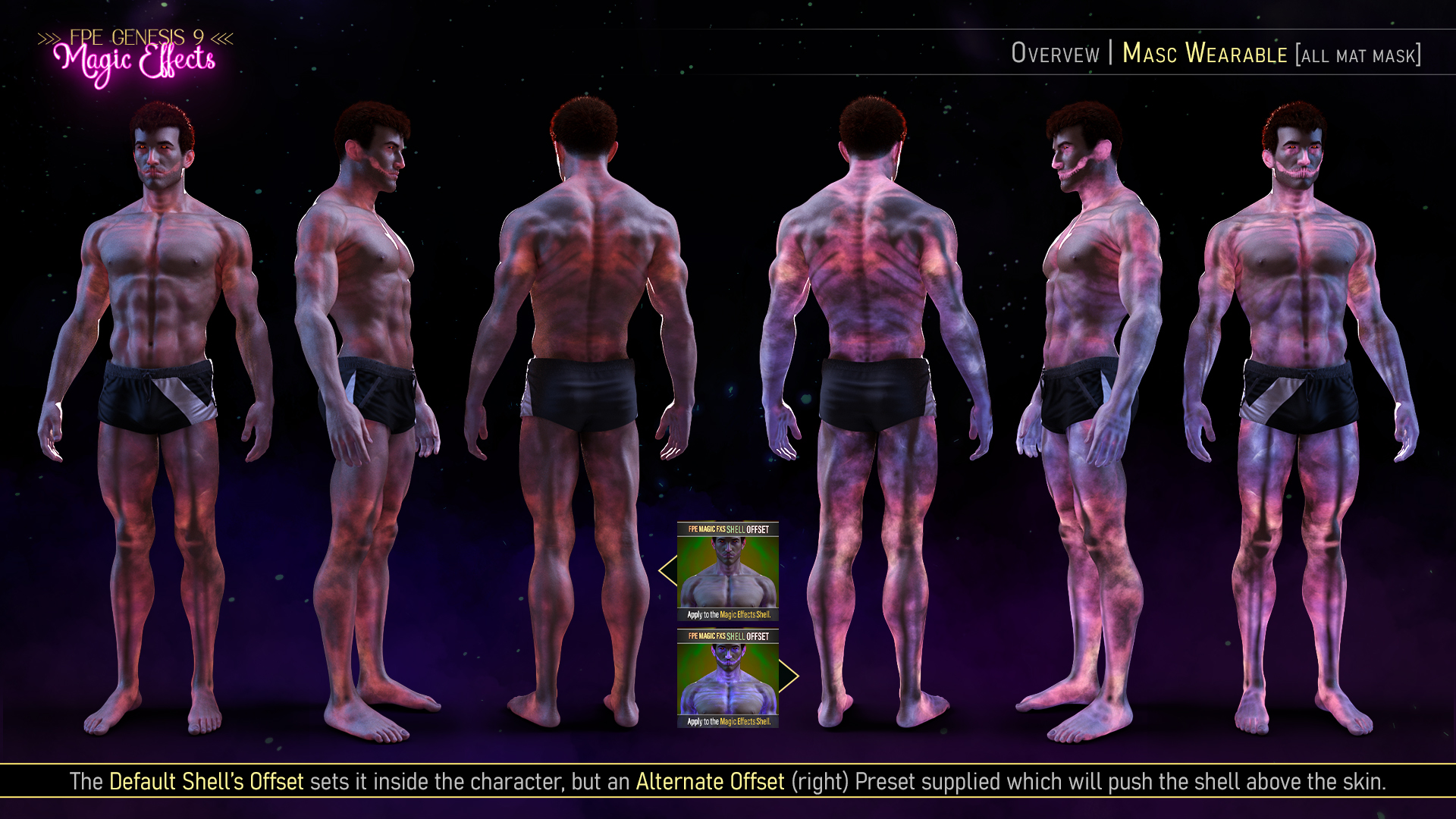

Here is one in action: https://www.daz3d.com/fpe-magic-effects-for-genesis-9
