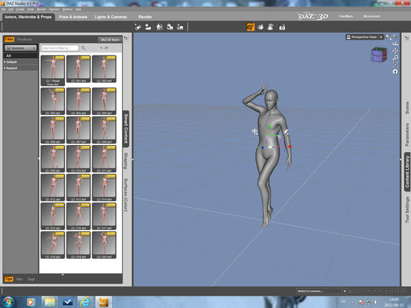

  • LyoneLyone Posts: 139
    Something intresting. The bug pose is not the pose 11 but the pose 20 from the Posed for V5 package. I don't if it means something. And why do I see a 2 before every pose?
    I put som screen picture.
    1600 x 1200 - 253K
    edited September 2012
    Why is everything locked to this bug pose? Every time I open DAZ or everytime I open a saved duf scene I get this same bug pose. If I open an old scene I don't see this bug pose but if I pose the figure or touch it and save and try to reopen, the figure explodes or I see the bug pose. If I save the exploded figure and reopen the scene, the figure loads well but in this freaking same bug pose. Why can't I save any other pose than this horrible pose?
    I'm so disappointed. I have a great program with great amazing potential but I can't do anything with it. I don't even know how to install content in it :down:. I would pay a lot for this program to work well instead of not paying anything and having a lot of trouble on using it.

  • Richard HaseltineRichard Haseltine Posts: 111,860
    The (2) means there are two copies of the file installed, in different places on your system. If you right-click on them you should be able to tell it which to use. As for why it is applying, by name - do you still have the files in the /data/DAZ 3D/Genesis/Base/Morphs/People/Genesis/Poses/Posed for V5/ folder? If so, remove them - it may be that DS is treating them as morph files, since they are .dsf files, though I would expect it to take account of the content when reading them and applying each in turn, ending with 20.
    OH GOD! The freaking pose is GOOOOONE!!!! Thank you so much. This pose behaved like a virus and it was a nightmare to see it in every step I did in DAZ. I had headache just seing this pose. Now it's GONE and the application is working again! Now I can put some pose on Genesis and when I save it and reopen the scene, the figure comes with the right pose. No more freaking pose. Thank you so much. Now I can play a little more with DAZ Studio 4.5.
