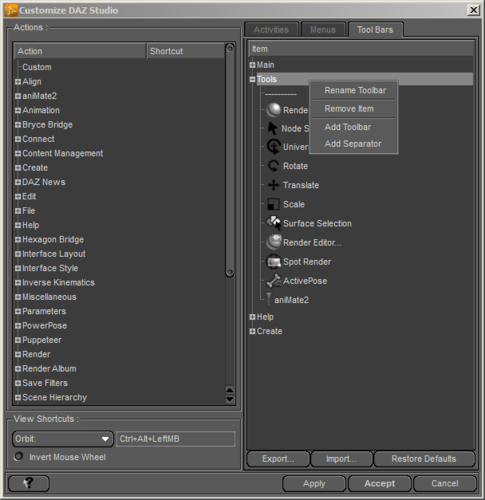

    I can follow as far as the "right click to enable the tool bar". There doesn't seem to be an enable option, unless I miss your meaning (or otherwise went off track somewhere). If I "Add Toolbar", it seems to just add a new listing with no content.
    Thanks also for the link, but the link to the PDF leads to a "404 Not found." Right click-save link saves a blank or defective pdf.

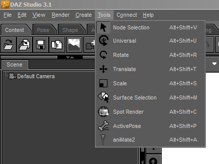

    Come to think of it, none of the Figure Setup Tools seem to be there. Neither the Property Editor, Poser CR2 Exporter, Skeleton Setup, et al.
    A head scratcher. I must not have installed it correctly.

    Select the toolbar that you want, Tool, right click on it when it is selected, and you should get a pop-up that says 'Enable Toolbar'
    I will look into the PDF thing for you as well.

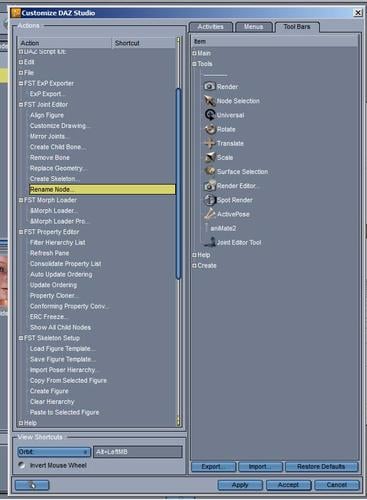

    If you look in the Customize menu, on the left-hand side, you will see all the FST items. I don;t know how you get them all across in one go, but you can drag individual items across, and put them in the Toolbars pane on the right hand side.
    You could create a new toolbar just for the FST stuff I think.

    Thanks again! Hmm, I don't seem to have a "Classic" listing like you do. Just for kicks I enabled the Toolbar under Content, but that didn't do the trick.
    I checked my Plugin directory under DAZ 3, and the dll's for all the Figure Setup Tools seem to be there, if that is indeed what is pertinent here.
