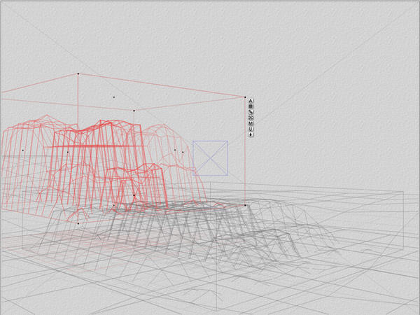

    I see now another problem. Your waterfall face is actually the sheer side of your terrain object.
    You should really use the Terrain Editor to create the (near) vertical face, then you can use different brush effects to make the water ripple more or less how you want it to.

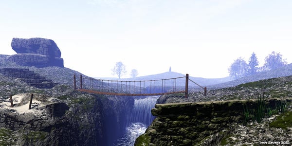

    Waterfall - water is mostly transparent but has a higher refraction index than air. It depends very much on the angle the light hits it. This can nicely be seen in TheSavage64 waterfall and tdrd's waterfall is essentially in the shadow.

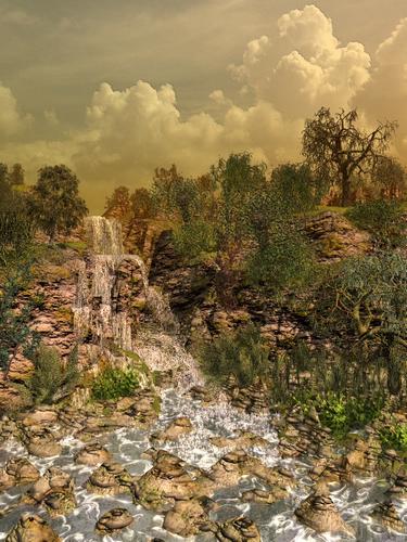

    Waterfalls are an obsession of mine, and I have found that each waterfall had needed a different material, depending on it's placement in the scene, and the way the light is falling, as Horo says.
    If I want to make a complicated waterfall I often use Symlats as well as terrain objects to build it up, or will have to or 3 layers of terrain objects, each a duplicate of the previous, but moved a thiny tad up and outwadrs and then with areas erased and a different mat put onto the 2nd layer.
    This is an old one, done in Br5 Bryce 7 has so many more materials it should be a lot easier.

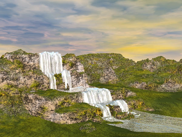

    This was a quick demo I did for someone a while back. Quite lo res, and a simplistic waterfall. Material was just for demot, so it showed up well.

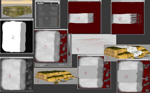

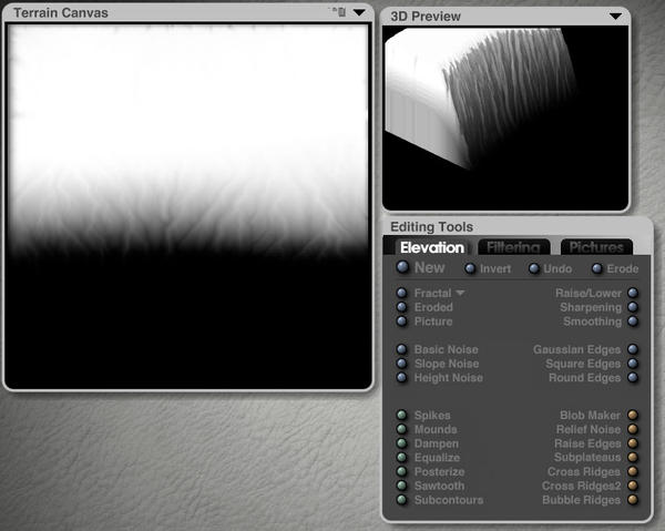

    It will be cool, if you could post a screen shot of the Terrain Editor of the waterfalls you painted, it will give us, newbies an idea how to go about it.
    Mine was a lot more simple than Chohole's
    All I did was to create a new blank terrain.
    Use the plain brush (at a large size) to make the top side white (high) with a decent enough fall off.
    Then using the "eroded" filter until the ripples look about right(ish).
    Then I squashed the terrain in my scene until it fitted nicely into the groove I'd cut out of the main terrain.
    A stretched sphere at the base of the waterfall with a plasma material applied gives the foam/splash effect.
    708 x 565 - 73K

    If you check Screen shot 10 on my images above, you will see I have erased some of the terrain, so that it is would appear as trickles rather than a full flow.
