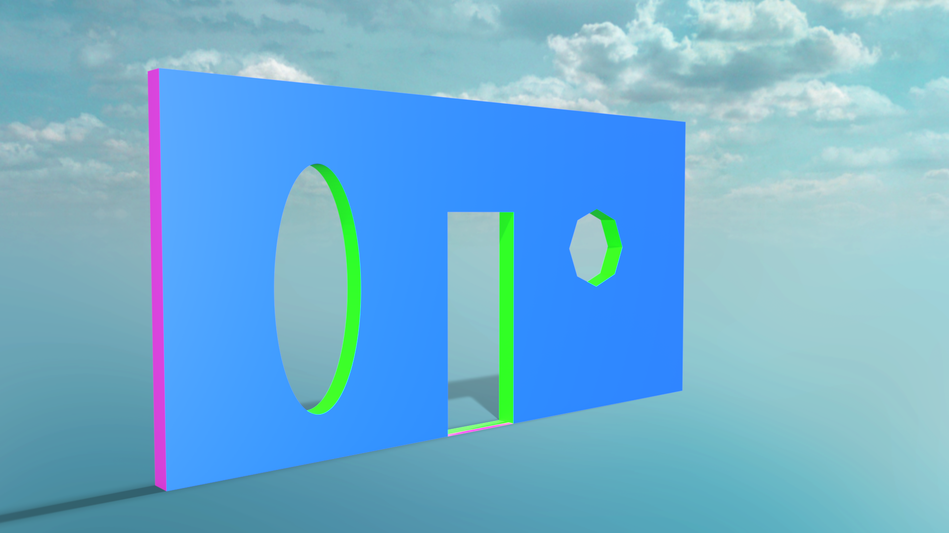

Both formats export four surface/material zones:
  WallFront    The visible front face (brick, stone, plaster)
  WallBack     The back face (drywall, paint)
  Jamb         Inside the cutout openings (wood trim, painted reveal)
  WallEdges    Top, bottom, and side edges of the wall
In Daz Studio, each zone appears as a separate surface that can be
independently shaded.

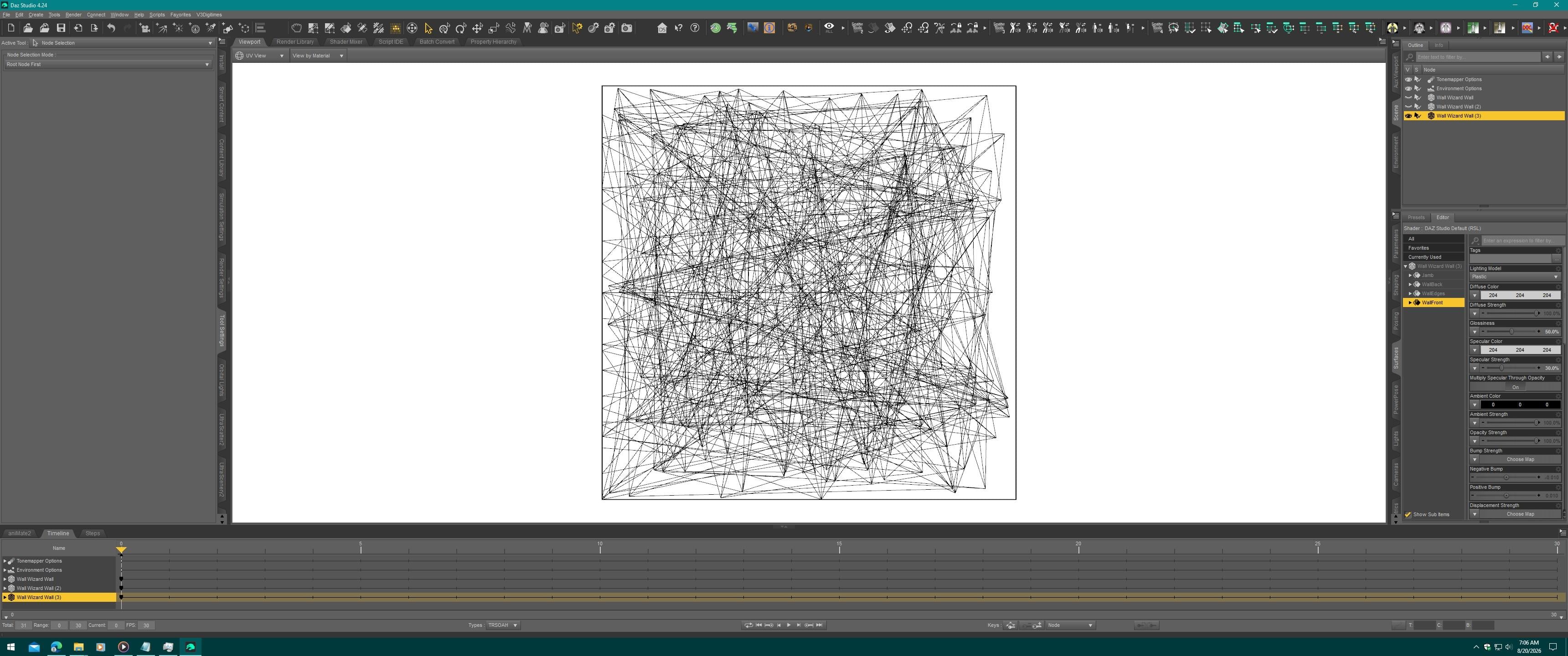

    It only works with a wall that it creates, and currently it is pretty much USELESS as the UV's that are generated for the WallFront and WallBack Surfaces come in looking like this:
    Which so basically, you cannot use ANY texures on that wall.  I had to reExport the wall into MAX to fix the UV's and once I was done and happy with the results.... I requested a REFUND for this product as it's clearly broke.  You are better off using Boolean operations in another program and just making your walls and windows there.
    By the way, Importing JUST the wall with no Door or Windows cutouts results in the same Horrible UVs, so this was not Operator Error.
    Thank you for taking the time to lay this out so thoroughly — and you're completely right. The WallFront and WallBack UVs were being written to the DUF in a format that Daz Studio misreads, which scrambles the coordinates exactly the way your screenshot shows.
    In all honesty, it slipped past my own testing: I'd been checking the walls with plain shaders, and a solid shader color doesn't use the UVs at all — so it looked fine on my end. It's only when you apply an actual image texture, which reads the UVs, that the scramble shows up — which is exactly what you hit. That's a real bug on my end, not operator error, and as you correctly noted it happens even on a plain wall with no cutouts. I'm genuinely sorry you lost time re-exporting into MAX to work around it.
    The good news: your report pinpointed the cause, and it's fixed. The UVs now export as a clean, standard planar unwrap, so image textures apply correctly. A corrected, signed update is built and on its way to the store.
    Your refund is completely fair and there are no hard feelings whatsoever. If you'd ever like to try the fixed version once the update is live, I'd be happy to help you get it sorted — no pressure at all. Thanks again for the honest, detailed feedback; it's exactly what made the fix possible.

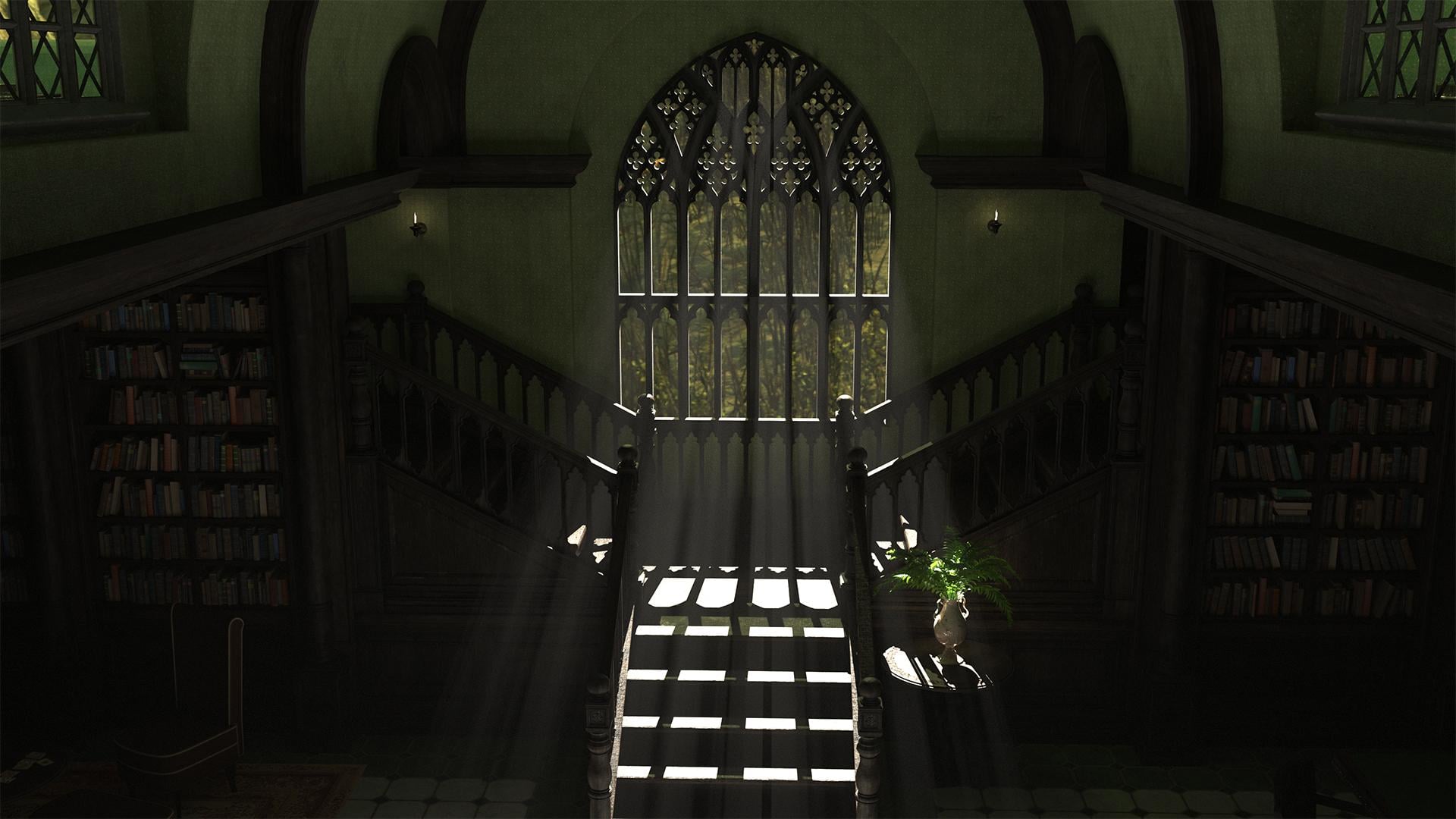

    edited August 27
    This is another Wall Wizard update window replacement in place preserving the wall texture (using an atomosphere cube primitive from VDBWizard).
    Wallwizard cut out the old window and created a larger hole in the wall, added a jamb and a back wall and transferred the current wall texutre to the jamb and backwall with only a few clicks.
    1920 x 1080 - 1M
    One more thing, since you mentioned plain walls: there's now a "None" option in the shapes dropdown, so you can export a wall with no cutouts at all — and with the UV fix, those texture cleanly now too.
    That is all looking really good and glad that you were able to fix it so quickly! Nice Bug squashin' for sure.  With the abilitity to cut into OTHER walls I will definitley pick it back up in the future.
    I also have a suggestion for an Add-On.... "The Roof Wizard Add-On"... (because it sounds better then the Ceiling or Floor Wizard I think)  Any way, How about taking all the cutting tools for the horizontal and make them vertical too!
    It would be great to be able to cut that cylider into the ceiling to add a spiral stair case, or Stove Pipe (or any pipe for that matter) into that cabins roof, the cabin could also use a chimey cut into its 2nd floor and then through it's roof too.  Not to mention that it also needs it's 1st floor ceiling Cut for the regular stair case (standard cube or rectangle cut) to access the 2nd floor of the cabin. But most importantly of course, would be cutting into the floor to add access to to the super secret elevator hidden under that big rug, that leads to my underground test lab.(What?  Only me?....Weird).  Well I hope that gives a brief idea of the benefits of making the Roof Wizard,  (think sky lights too...). and I would definitely buy that as and Add-On. (or StandAlone, whatever)
    Post edited by mrpenguin76 on
  • EZ3DTVEZ3DTV Posts: 1,691
    edited August 27
    mrpenguin76 said:
    Hello MrPenguin,
    I wanted to follow up on my earlier note, because your feedback stayed with me and the program has grown a great deal since then.
    Wall Wizard's next update is a large one, and it changes what the product fundamentally is. It no longer only generates its own walls — it now cuts openings directly into walls that are already in your Daz Studio scene, from any product, with no export or import step. You select the wall, Ctrl-click the doors or windows you want as openings right where you've placed them, and the cut is baked onto that same wall in place, with its original textures fully preserved.
    And it isn't limited to walls anymore. The same tools now cut through floors, ceilings, and roofs — including curved and assembled roofs — so skylights, stairway openings, chimney passes, and round windows through a curved roof are all a couple of clicks. It can even cut the silhouette of a posed figure through a wall, gaps and all.
    Every cut is repeatable: the program keeps the original geometry, so you can reopen a cut wall later, move an opening, and re-cut with no scars. The manual has been rewritten and illustrated to cover all of it.
    The update is nearly finished on my bench and is going through final testing and store submission now, so it will reach the Daz store (DIM) as soon as their process allows. When it lands, I'd be honored if you gave Wall Wizard another look — your report is part of why it became what it is, and I think you'll find it a very different tool from the one that disappointed you.
    Either way, thank you again for the honest feedback. It mattered.
    Eric (EZ3DTV)
    1160 x 922 - 1M
    732 x 860 - 847K
    1278 x 984 - 1M
    Post edited by EZ3DTV on
