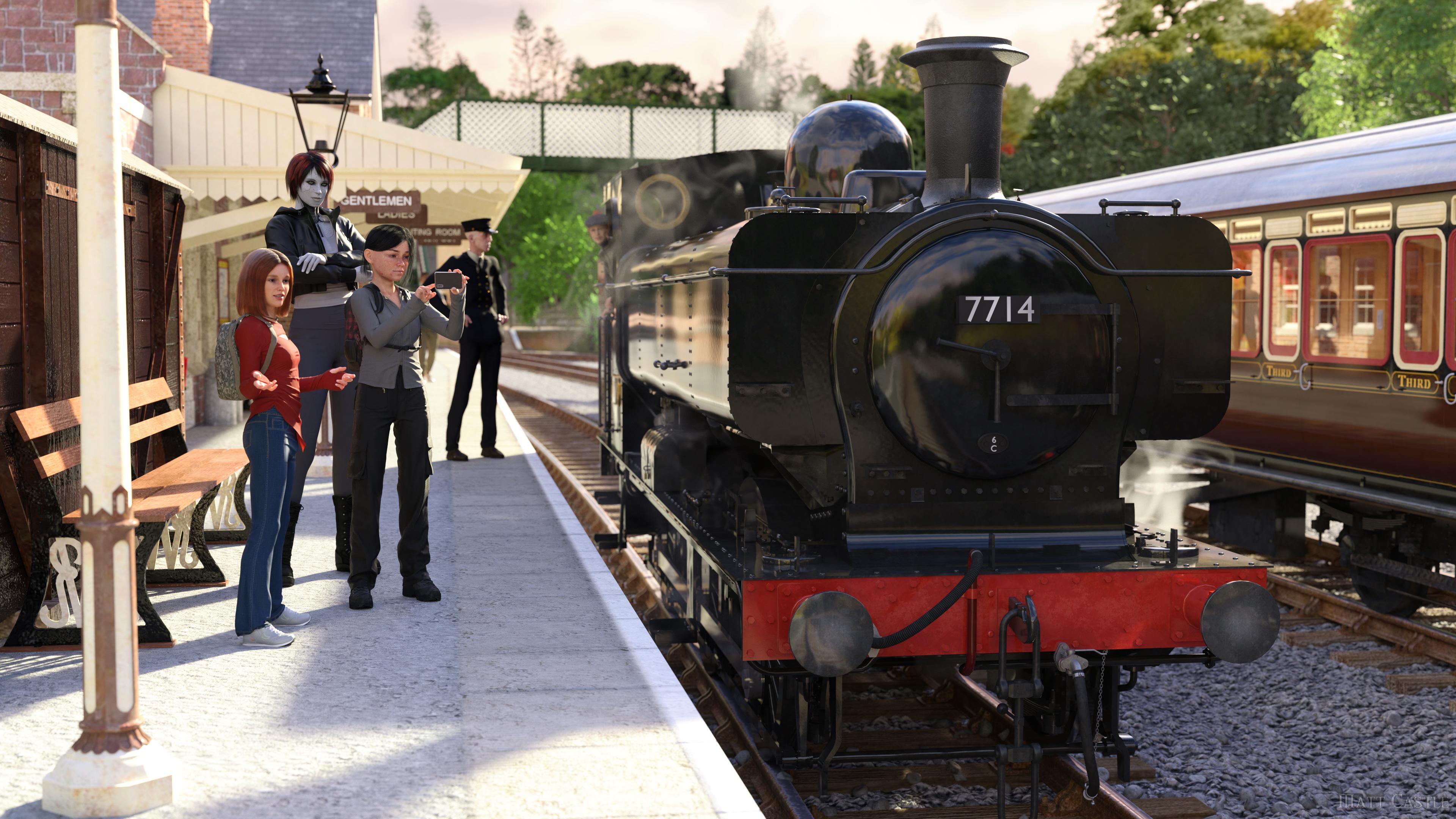

    If you hide everything that's outside the cone of the camera, then yes, it will significantly speed up the render, because rays will likely quickly bounce out of the scene and get terminated. However, this will noticably affect what's rendered, because it's a ray-traced render. When ray-tracing, it's not only possible but almost certain that objects near but outside the view can be reflecting (or blocking) light into the view, or they can show up in reflections (most obviously in sharp specular reflections like a mirror, but it can also very noticably impact diffuse reflections).
    Indeed, for the reasons, I do not personally like any tools that automatically cull objects outside the view. I deliberately put objects into scenes that are entirely out of the camera view, because the shadows, light and reflections from them - even if they can't be directly seen - are often extremely important to getting the scene to look right.
    For an example, when I was building this scene, I had to spend a large amount of time building far more of the valley than you directly see, because I was about to plonk a very reflective locomotive in it, so it would have been blatantly obvious if the world ended just out of view.
    However, even with a less specular object, ultimately all light we see outside of directly staring into a light source is a reflection (or, being pedantic, a transmission, refraction, diffraction, etc - although I'm not sure that Iray, at least in its DS implementation, can actually handle diffraction), it's just often diffuse enough that we can't make out details in it.
    3840 x 2160 - 2M
  • backgroundbackground Posts: 941
    edited April 29
    Matt, I had to look twice to realise that isn't a photo, it's extremely convincing ( tallest character apart ). Got to love a 57xx, although I prefer the 1930's livery myself.  ( the full 'Great Western' not the roundel. I think the roundel looks great on linen, and posters, but somehow looks lost on the side of a loco or tender. ).
