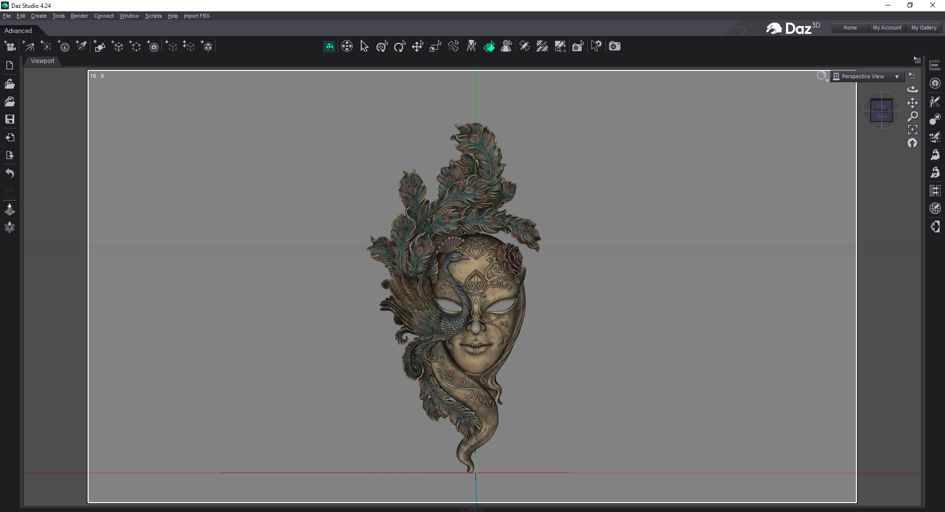

I transfered the .fbx file to an .obj file using an online program.
I imported the obj into Daz Studio 4.24.
I started with a base PVC map from Pd Iray Shader Kit 1 | Daz 3D.  Excellent product for a starting base.
I applied the most obvious base map, which was the face part of the mask.  That just turned a shiny brown.  Then I remembered once I had to adjust one of the bases with a tiling change because the base texture was too large using Daz Studio as the render engine.
Well, I have done numerous things now to apply the textures that come with this mask.

  • WendyLuvsCatzWendyLuvsCatz Posts: 41,766
    edited March 17
    it is UV mapped and choosing lambert 1001 for lambert1 etc works
    a lot of bits and surfaces
    1920 x 1040 - 460K
  • Jan_ScrapperJan_Scrapper Posts: 798
    Oh, my goodness...I used an online program to convert to an obj and the surface names were totally different!
    I thought, somehow you are seeing original surface names...I imported the FBX file into DS, which I did NOT know it would do!!!
    Thank you so much!!!
    I am well on my way to applying all of the textures.
    Learn something new everytime I open Daz Studio!!  What a powerful piece of software!!!

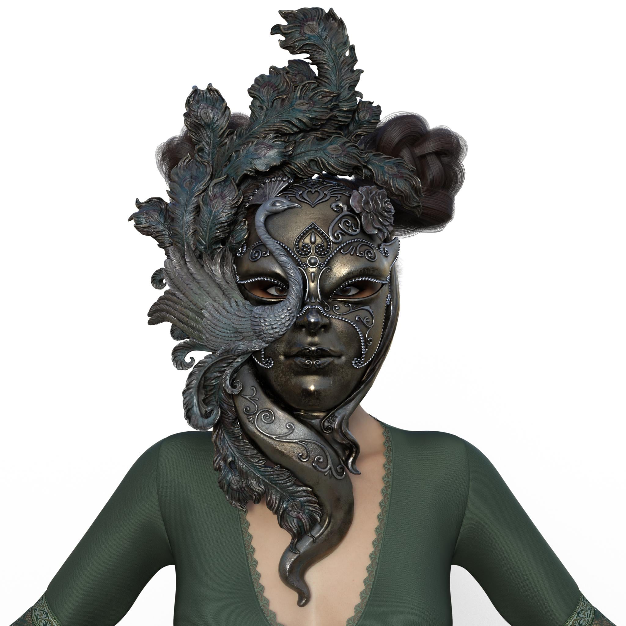

    Wow! so glad I came across this post Jan, that mask is amazing, thank you for putting the link to it!
    I made a G8F version out of itby importing the .FBX then selecting all individual pieces below the Group 19 and Exported them All as an .obj at 1000% Scale to a temp folder, then brought them back in at 100% Scale as One Geometry. Also a good fit for it on a Dev load G8F was:
    Y Translate = 136.3097
    Z Translate =  9.476129
    X Rotate= -12.09374
    and then change it's parent to the Head Bone saved it out as a new Prop (Figure/Asset)
    (for anyone else who wants to make one for the G8F)
    I saved mine out as a new Prop (Figure/Asset) after getting all the Textures Applied (I also converted all the .PNGs to .JPG's to make it a lighter load... Of Course it does look better with PNG's but I'm happy with JPGs) so now I have a have another Mask for the Ball!
    Jeez... I think I need to start uploading at 1024x1024.... that is ALOT bigger then I expected for a 2048x2048 lol
    2048 x 2048 - 2M
    Post edited by mrpenguin76 on

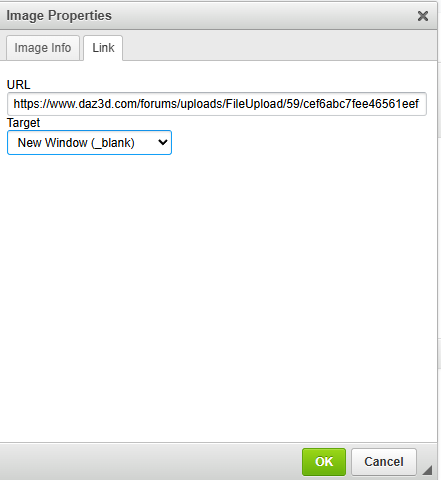

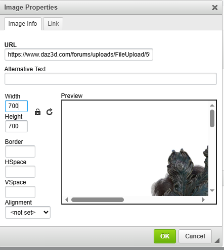

    they can be resized and 700 doesn't break the forum formatting yes
    443 x 495 - 43K
    441 x 480 - 15K
  • mrpenguin76mrpenguin76 Posts: 117
    edited March 22
    Nice! Thank you for the tip Wendy ;)
    Looks much better at that size, instead of exploding on the screen lol
