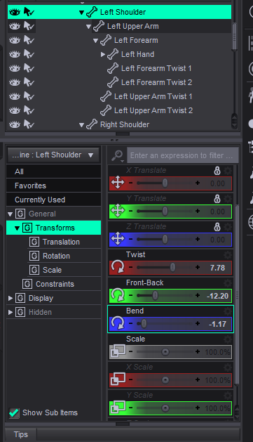

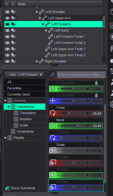

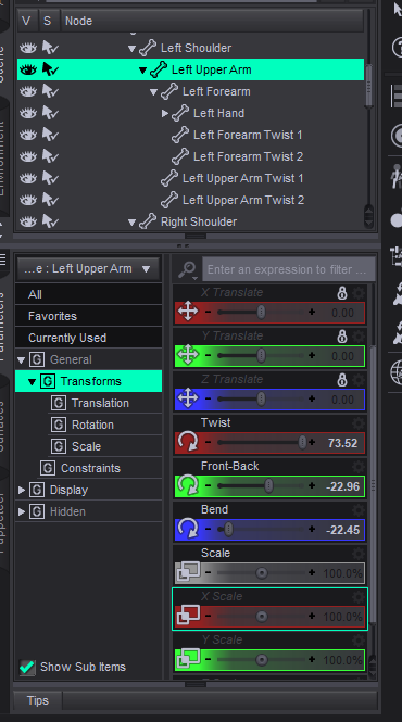

  • felisfelis Posts: 6,581
    edited February 27
    You need to get the arms a little forward, to get them free of the torso.
    Here is my settings for left arm. Right arm is almost ther same, I mirrored, and then adjusted one of the arm so they didn't clip.
    I always start with the upper arm, and if that reached its limits, I start using the shoulder. I generally try to avoid being fully at the limits inless I can't avoid it.
