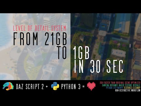

    That's helpful. The dev posted on Renderhub's forums that he thinks it completely replaces https://www.daz3d.com/scene-optimizer and goes beyond it.

    There is a video on YouTube about it:
    Daz LOD System (Better Scene Optimizer)

    I feel that they don'y really describe how their system works.

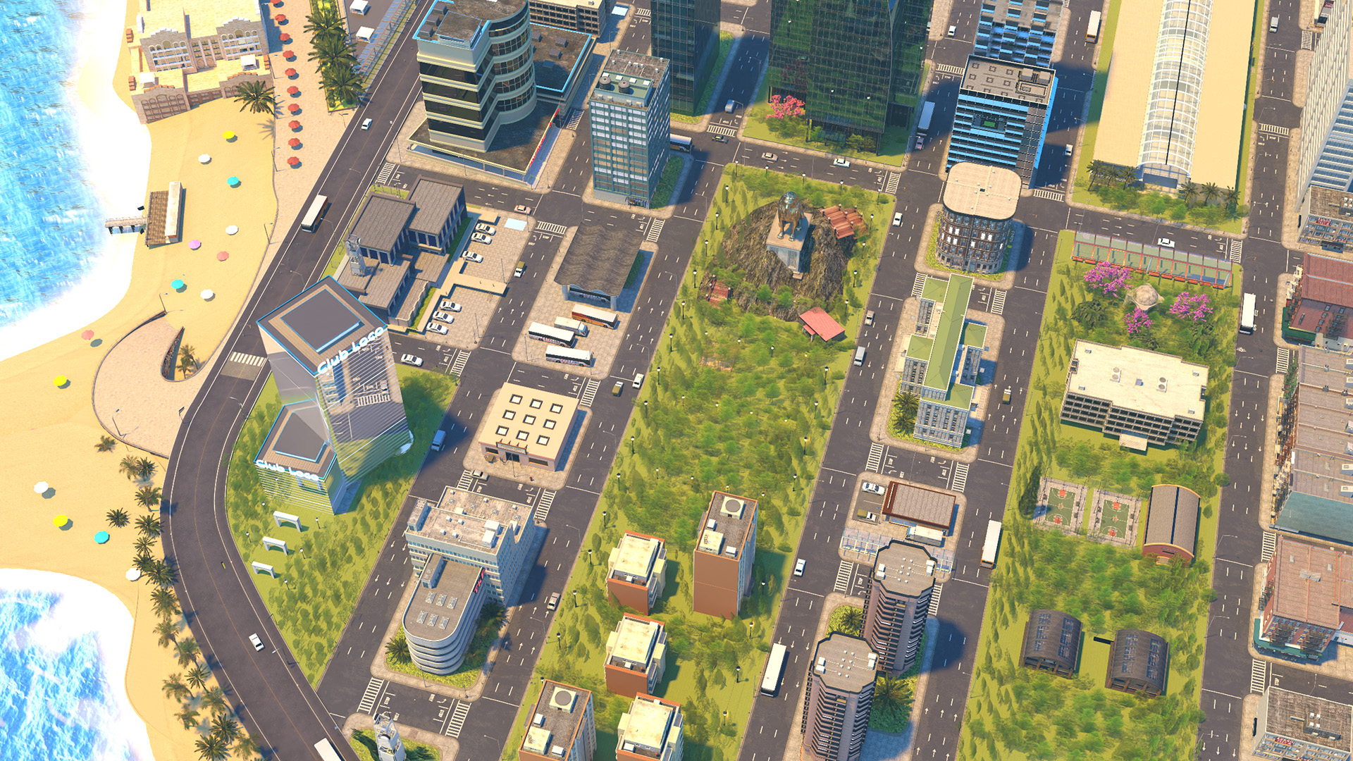

    In their promos they are mentioning 21 GB original textures compared to 1GB compressed textures. But Iray don't use compressed textures.
    And the image they used was a birds view, and in a renderer that was not Iray.
    And in the video they are basically mocking scene optimizer for being slow.
    It is likely that Python is way faster that Daz Script, but personally I lack to understand how they do it.

    Presumably they rescale the texture and replace it, not "compress", just like scene optimization does. The difference is they do it "faster" somehow. How can you tell it wasn't Iray?

    This image, if it is Iray it look like a toonish one. Very homogen colors.
  • memcneil70memcneil70 Posts: 6,169
    That was my first thought or from a game program.

    Competing products are nothing new here. But in general i see PAs being respectful to one another and avoid direct conflict.
    Directly mention another a PA product in a diminishing way in your very main promo image is not being a good sport.
    They should concentrate in providing proper real examples and not a simple bird eye view of a city; that is extreamly narrow view (pun intended) in terms of Daz use cases that could benefit of VRAM optimization.

    The image/video they are pushing seems to be demonstrating that those tiny buildings would still be 21GB in texture-size Daz native - with so many and so visible that's likely but its far from a typical Daz scene and there are specific assets to do cityscapes with reduced and manageable textures (Stonemason et al). I'd be interested in seeing some (character-full) more typiclly Daz scenes and the results of those.
    One of the (many) benefits of Scene Optimizer is you can pick and choose what textures get reduced (and by what factor) - this doesn't read like that.
