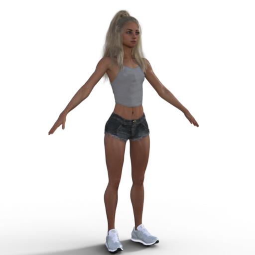

  • richardandtracyrichardandtracy Posts: 8,192
    edited February 17
    A zero pose is one where every bone's rotations (eg up-down, side-side & twist) is set to zero. You will find many pose sets have a 'zero' pose included to act as a 'cancel last pose' . The pose below is the 'zero' pose I included in the G9 walking pose set here.
    It does mean, if you download lots of poses, you end up with lots of zero poses... Which will all be the same.

    512 x 512 - 122K
