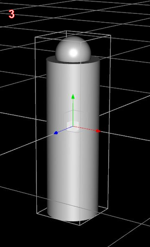

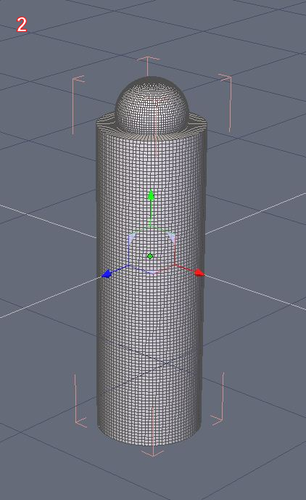

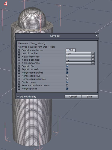

    Okay, Here is what I do and it works in the Object files when I use Hexagon.
    Step one: Export Multi Selected object as a Daz Scale WaveFront Object file. Clear scene
    Step two: Import New object file into DS at DAZ defaults. That is Image #1 as you see the Axis is at bottom not the Center. I want it centered.
    Step three: Send To Hexagon, once Object is selected the Axis SHOWS centered for the Object, That is miss leading. Look at it and you will see the bottom of the object is still at the Wolrd Base. I move the object down so the axis lines up with the World base Axis lines. That's Image #2. I now save this as the Object File with Scale set to 1 and Unit of file set to cm. That's Image #4.
    Step four: I import the new object into DS, that's Image #3. As you see the Axis is now centered in the object.
    P.S. Watch your Save settings in Hex, You might not WANT flip textures selected.
