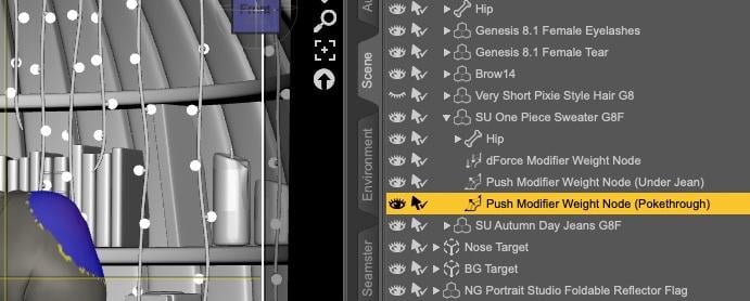

    To solve it, instead of redoing the simulation, I added a 'New Push Modifier Weight Node...' through the Create menu, then I switched to the node brush tool, opened the tool settings tab, added a new push modifier, selected all the geometry before using Weight Editing > Fill Selected > 0%, before painting the part I wanted the push modifier active which is visible on the following screenshot:
