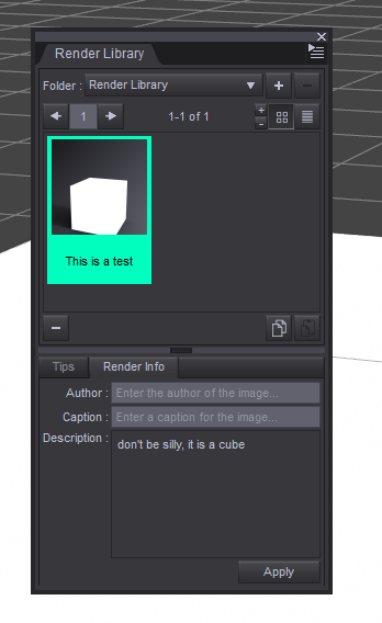

    If you save to a render Library then there is a Render Info tab that can store notes, though there isn't currently a way to auto-populate it (a script could do the job).
    348 x 568 - 36K
    I did not know this thank you.
