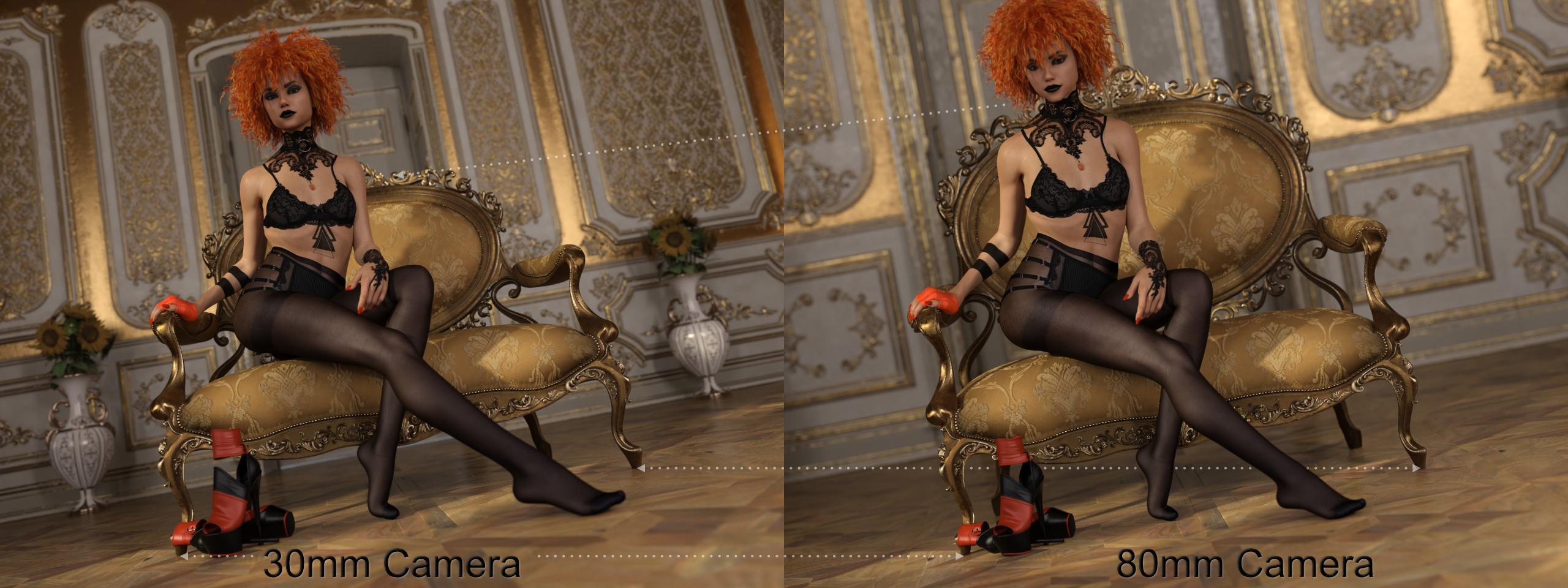

  • markusmaternmarkusmatern Posts: 618
    edited December 2025
    This is a little demonstration of different lens settings. The images are aligned, so that the front feet of the sofa are in the same spot in the image:
    The 30mm lens shows much more background than the 80mm lens. Even if the 30mm lens technically is closer to the subject.
    Also the distortions are much larger using the 30mm lens. The leg looks longer and the backrest of the sofa lower.
