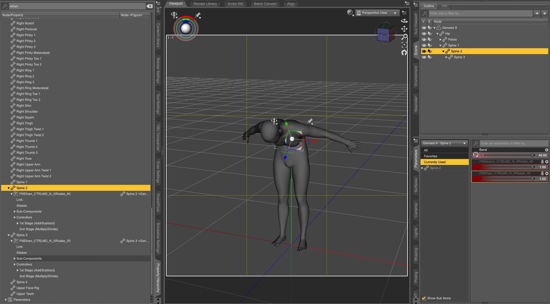

    @3DSaga > To see the problem, load Genesis 9, bend Spine 2 or 3 to the higher limit and while keeping Spine 2 or 3 selected, show Currently Used with Show Hidden Properties active: you should see Ethan's spine2_FNEthan_CTRLMD_N_XRotate_40 or spine3_FNEthan_CTRLMD_N_XRotate_35 at 1 (and any other Feng character with the same problem should have their respective 'cbc morphs' active too: in my case, I also saw the one from Eleanor).
    To fix the problem, you'll have to add the morph controling Ethan's body as the second stage controler (or something like that) on spine2_FNEthan_CTRLMD_N_XRotate_40 and spine3_FNEthan_CTRLMD_N_XRotate_35.

    If the Property Hieararchy panel is not open (I don't think it is by default), and if you don't know how to open it, you can open it by going to Windows > Panes (Tab) and search for Property Hieararchy.
    enlightened
    What you should see if the problem is not fixed on your computer:
    You can also check in the Property Hieararchy panel with Genesis 9 selected, searching for Ethan and you should have one property related to him on spine 2 and one on spine 3.
    If the 2nd stage of either property has Ethan Body as shown on the following screenshot, you're good (and you likely forget you fixed it a couple of months ago). If not, you'll have to switch the parameters panel into Edit Mode, then click on 'FN Ethan Body' and drag and drop it onto 2nd Stage:
    At that point, if you select back the spine bone impacted by Ethan morph, it should now no longer have any Ethan property dialed at 1.

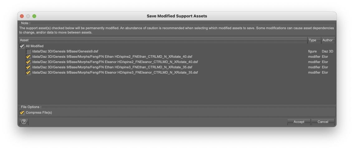

    You'll have to do it for all Feng characters that have the same problem, and once you're done, the easiest way to save these changes is, with Genesis 9 selected, to go to 'File > Save As > Support Asset > Save Modified Assets', and enlightened be very cautious to only save the properties you modified. enlightened
    As an example, for some reasons, DS though Genesis 9 was changed too, so I unchecked it, keeping only Ethan and Eleanor related modifiers checked (I also don't know why DS decided I was the author of the modifiers):
