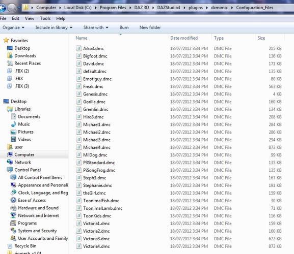

  • T JaimanT Jaiman Posts: 560
    On XP it's C:\Program Files\DAZ 3D\DAZStudio4\plugins\dzmimic\Configuration_Files
    So I guess those come with the plugin included in Daz...
    I wonder why the pro installer wasn't updated with all the dmc's, as well?

    32 or 64 bit? they are in 32bit, yes even the free version as that only does lipsync though I believe 64bit can use mimic live.
  • Harry OminousHarry Ominous Posts: 58
    well, that would explain why i'm not seeing the file
    i've got the 64 bit version
    i'd have thought there must be some way to get the file though. i suppose i could build it myself, but it seems a bit like reinventing the wheel
    edited September 2012
    Weird. Ticket-worthy... that's gotta be an oversight. Shouldn't have to buy a lesser Mimic to get all the configuration files for the higher-end ones.
    If I recall correctly, you can have both 32-bit and 64-bit DS4 installed, as long as they are the same version.
    But MimicLive is still a plugin, it should show up. Is there just a dll?
    I believe MimicLive appeared a few versions, of 4, ago, but I doubt anyone is running a DS4 that old.
    If you have DS3A, it has the M4 dmc (but obviously not the Genesis dmc). Dunno about not-advanced.

    you can always unistall it after grabbing the dmc files if you really don't want it.
    but since exporting Genesis as a .duf scene with lipsync works in Carrara, you might want to keep it just for that.
    I just looked in the 64 bit
    I did not put these here, Mimic pro must have or they came with it
    have a look
    809 x 701 - 196K
    there was a page on the old site with the configuration files for all the Daz originals and other figures.
    they seem to have misplaced it
    the link was on the mimic page in the store.
    you can install the DS4.5 32 bit as well as the 64bit, infact you NEED it for lipsync, the file for M4 has to be in there or lipsync would not work.
    have a look
    thanks
    i'm not intending to install DS4.5 (either flavour) until all the add-ins that i've got have been updated to run with it, and i've already checked a couple of times for anything related to MimicPro or LipSync in the relevant folders, and found... nada
    to be honest it wasn't a great deal of effort to create an m4.dmc file
    it could have been made into a one-click process, of course, because all the software needed to do was to look for any installed visemes in the relevant .cr2 file, look for any expressions, and then just install them in the .dmc file (and as a tiny courtesy, add an entry in the relevant configuration file too). still, the fact that it's copyrighted from back in 2008, probably tells the story of how much effort's gone into it recently
    hey, i'm sure the next big release will feature GOD RAYS though...oh, and genesis... maybe adam. and eve. and a talking serpent too
