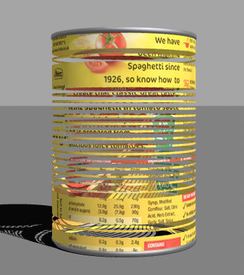

I can't believe I can't do this, I've done it before.
I have a tin can with grooves / indentations in it.
Made with a positive cylinder and negative torus's.
When they are grouped together they make a single cylinder with the grooves in it.
All I want to do is to map the label around the tin and into the groves.
I tell it to map it cylindrically which it does, but when I look at it, it looks like it is
mapping a complete copy of the label in to all the separate grooves and a complete
label on the tin as if they were separate objects. What am I doing wrong?
Any help / advice would be greatly appreciated.

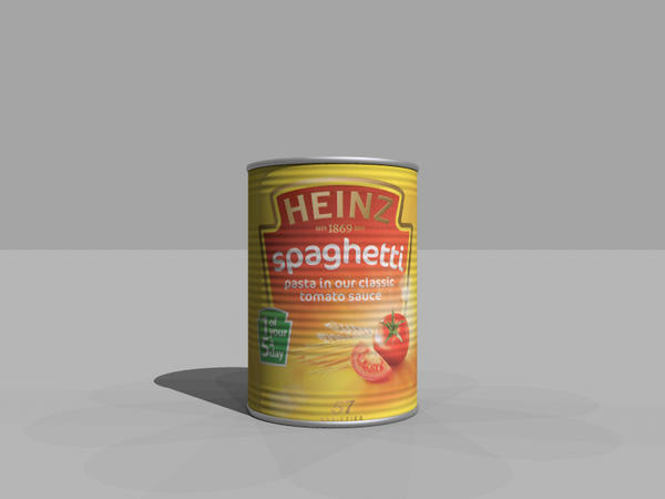

    Converting to a mesh exporting and importing may work, but geometry resolution will be lost. Likewise modelling in Wings3D could be a way.
    Here I’ve provided a material solution.
    The tin geometry, the cut cylinder is set to be a lens material with 0 refraction, this can have reflection or diffuse to interact with light to show off the geometry.
    Inside is your label on another cylinder – this shows up through the lens.
    It’s not perfect, but it is interesting.
    800 x 600 - 79K

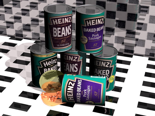

  • StuartBStuartB Posts: 600
    Thanks David. It is an interesting way to do it.
    I have done it before with bean cans but can't remember how, and I don't have the original scene file for it.
    Although I picked the wrong background at the time I was quite pleased with the cans and labels.
    800 x 600 - 326K
  • David BrinnenDavid Brinnen Posts: 3,136
    chohole said:
    What happens if you set the material on your negative toruses to 100% transparent and click to blend transparency.
    They cut into the tin leaving it in slices. I can see what you are thinking here. This is a far more difficult problem that it at first appears... You'd think there was an easy way to get around this... but... nothing springs to mind.

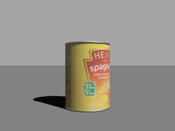

    OK, I had another idea. Bump mapping.
    How does that look?
    800 x 600 - 87K
    Yeah thinking about it, that would only work if the cylinder was a solid chunk and not hollow. I got something similar to work on a terrain because I had it set to solid.
    Even using one of Rashad's additional primitives with set to solid when boolean rendering. It still did this to me.
    347 x 390 - 75K
    Thanks again David. That looks like what I was after.
    Never thought of doing it that way. Still learning.
