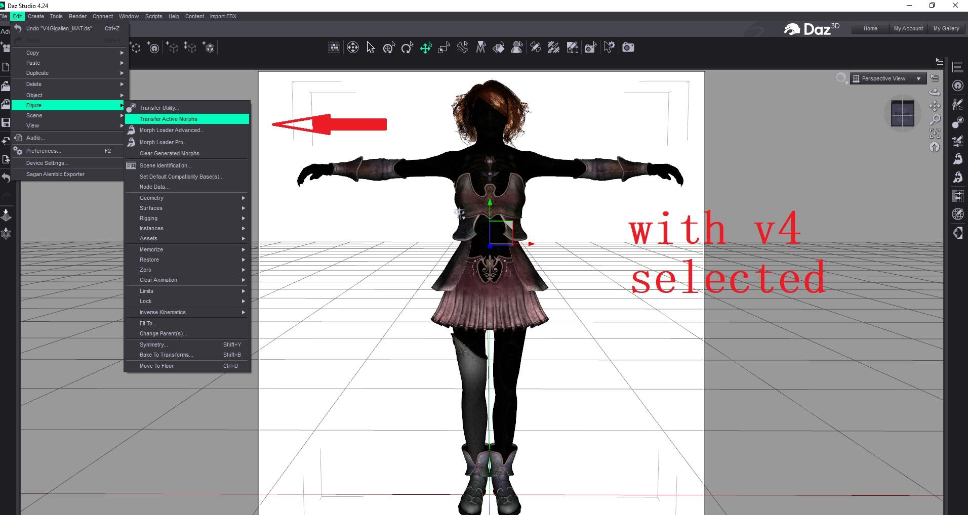

    select your figure with clothes fitted and click this
    1912 x 1018 - 336K

    so clicking on Transfer Active morphs didn't fix it?
    Did you try a smoothing modifier too?
    you want to apply a morph to V4?
    she is Unimesh
    export an obj of M4 and use morphloader
