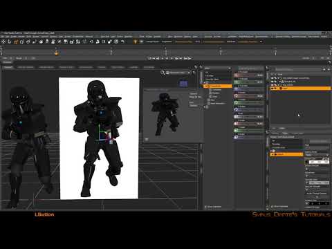

    Not long ago I made a youtube video showing the steps of rendering a figure with custom aspect ratio and creating an billboard out of an primitive plane with an opacity map. The rendered PNG was saved with transparent backround but unfortunately Daz Studio can't use it so I had to create the opacity map by hand in an image editor, the transparent PNG was still useful while doing this. At the end of this video I tried the Point At camera but it didn't work as expected but I think I should have exported and imported the plane once to get the orientation right.
    DazStudio DeathTrooper Billboard
