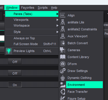

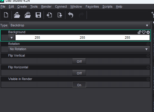

    Another option you can use is the ENVIRONMENT pane. Select WINDOW>PANES(TABS)>ENVIRONMENT. Then change the TYPE from NONE to BACKGROUND. Then change the color as desired.
    Best of luck!
    372 x 346 - 30K
    532 x 170 - 10K
    523 x 382 - 21K
    Post edited by Write Idea on
    Best of luck!
    Did as you suggested.  Sorry, it didn't work.

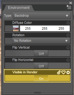

    ...OK just ran a couple tests and found the issue,
    Check to make sure the "Visible in render"  control (at the bottom of the Environment tab) is set to "on".. Even with it "off" Iray view mode will still render.
    The first render attachement below is with the "visible in render" control turned off while the scene is with it turned on.
    239 x 307 - 17K
    958 x 608 - 110K
    958 x 608 - 349K
