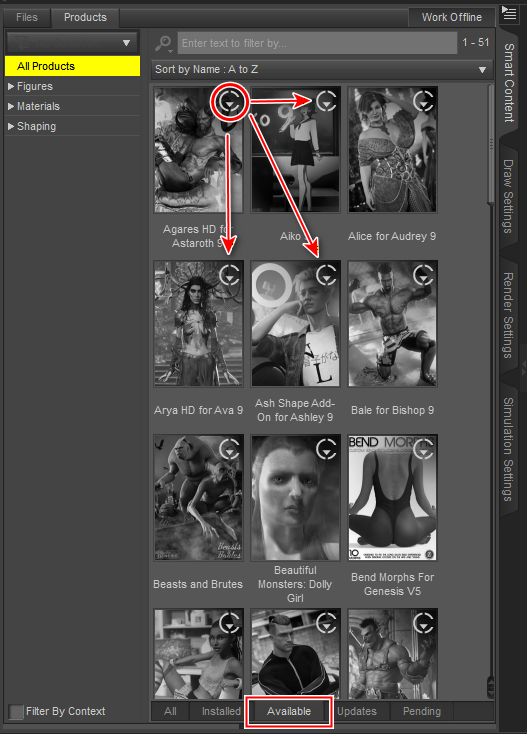

I had to reinstall my DAZ Studio programs and assets. (long story as to why).
I am now trying to understand why some assets do not seem to have installed, but are listed as "Available" instead.
I have attached two images to further illustrate my questions.

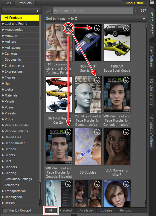

In the first image is the "All Products" tab with the "Installed" products. I have also circled an icon in the upper right of the first icon as I am  unsure what it means. Some assets have it others do not.
In the second image is "All Products" tab with the "Available" products. I have circled the same icon and note that "all" the assets have it on each of the icons. They all have it here.  These asset icons are all grey, indicating they are NOT installed.
I am trying to understand why some installed when others did not. I double-clicked on one of these "grey" icons in the "Available" tab and it installed. I checked the "Browse to Folder Location" and it displayed a path to the "MyDazConnectLibrary" location.

I guess what I am asking is why the icon in the upper right of the asset icons display whether it is in the "MyDazConnectLibrary" or not and it there any way to install the "grey"ed out assets without installing them in that folder?
I was under the impression (wrongly perhaps) that Connect installed assets could cause issues with inserting and rendering assets into a scene.  Is there any option that would allow me to install assets without placing them into the "MyDazConnectLibrary"?
What options are there in relation to this issue?

    What you are looking at is the "Daz Connect" (installed from inside Daz Studio) view. Colored images means installed, and the little cirkel with down-arrow means ready to download (with Connect). If you do that you will have two independante installs and Connect will take priority.
    The grey images should mean not installed, but ready to download with Connect. If there are products that are grey but installed with DIM or manual, then you have an issue, because Daz does not consider it installed.
