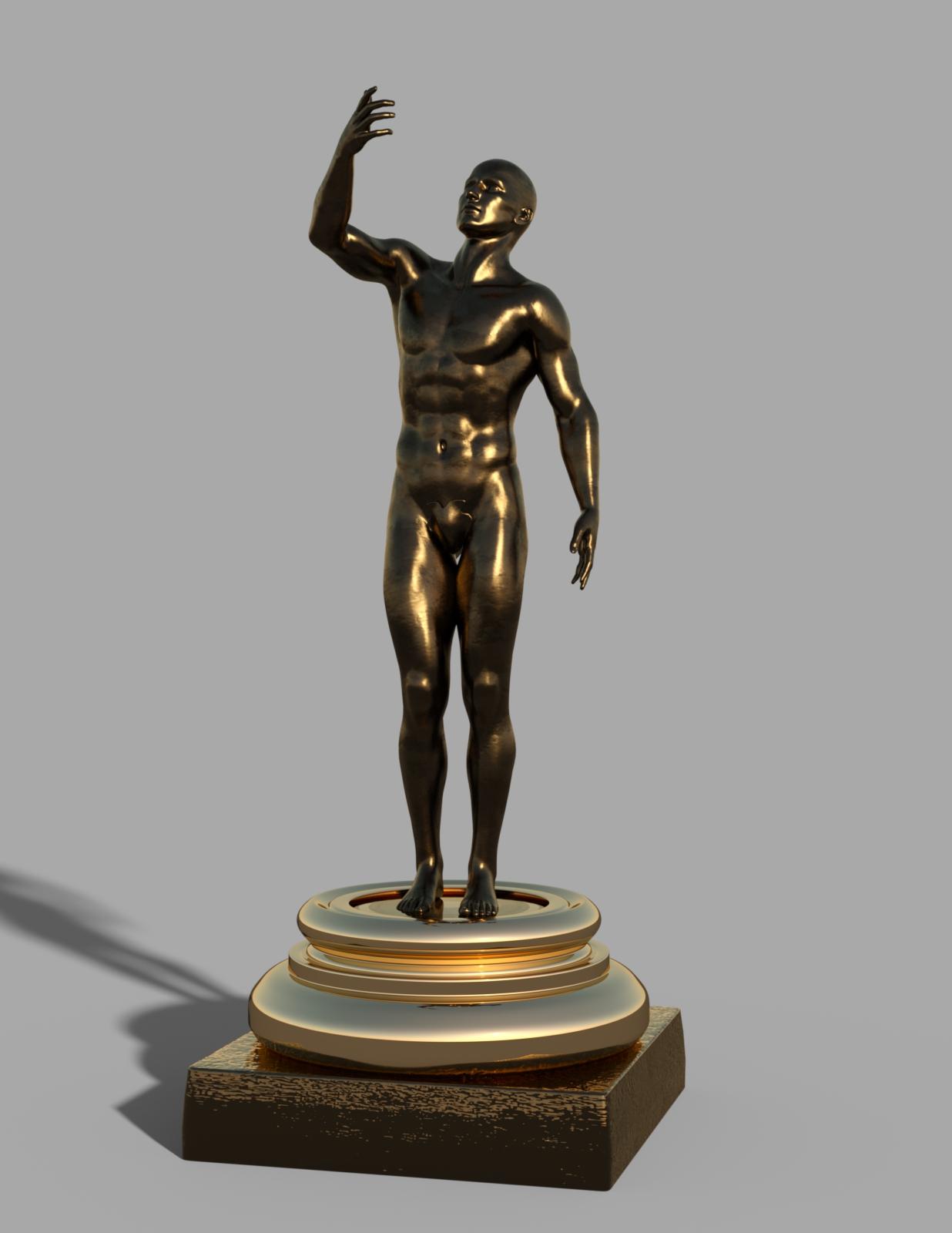

    Here is a quick bronze statue I played with using several options for bronze shaders in the MEC4D product. You have incredible choice from shiny to anodized to pattern engraved to dirty and more. It was lit with the built-in Sun Sky Only.

  • SzarkSzark Posts: 10,634
    oh shiny (as in the Firefly sense). I have a need for Bronze shame I didn't take the oppotunity when it was on sale. Oh well I will have to make my own.
