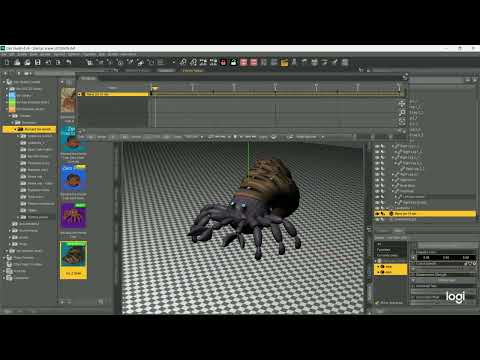

I can't find a way to make Mirror poses for my Hermit Crab.
Doing it manually is really fastidious.
Does the Symmetry feature only works on Genesis/Human Figures?
2404 x 1240 - 818K

  • Thank you for your answer. The prefix thing is not case sensitive.
    I realize now that I rigged my figure symmetrically in order to have identical sliders and coherent Property Labels for the Left and the Right Legs and Arms. (ie  back is negative, front is positive for both L & R).
    For some reason, Genesis Figures are unsymmetrically rigged, wich (at least for me) seems illogic and weird. ie you move the R Shoulder Front-Back slider and the Shoulder goes Back-Front.
    That's why DS Symmetry tool inverts the Y and Z values, but not the X axis value.
    I don't want to re-rig my Figure, It would ruin weeks of working on poses and animations.
    I think editing the poses .duf files in a text editor should do the job.
    I want my Crab to become a freebie before Xmas!
    Regards,
    Jean

    Thank you for your answer and teaching!
    You're right, prefix is case sensitive. I made a confusion between Node Names and Node Labels.
    But anyway I can't use the Symmetry feature because of my symmetrical rigging. Symmetry inverts the Y and Z  + / -  values and manual corrections are fastidious.
    Editing the Poses .duf files is easier and works well.
    Have a nice day!
