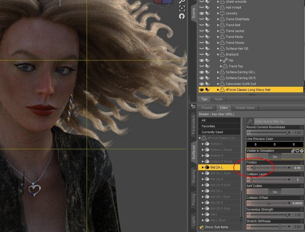

  • Try increasing friction. Absorbs energy and slows movement. May work. Regards, Richard.

    However, in words, without pictures: The co-efficient for friction is listed in the surface material parameters. Select one of the hair materials in the surfaces tab. At the top are the colour/texture/tiling parameters, and after you scroll down below that you come across the dForce parameters like weight/m^2, bend stiffness, shear stiffness etc. One of them is the co-efficient of friction. I suggest you take the figure that's there (probably 0.2 or 0.4) and double or treble the value to see if there's an effect when you simulate it again. If there is, it may be worth tweaking further up or down to get the result. Real values of the friction co-efficient would be in the range 0.1 (oiled metal on metal) to 0.8 (rubber on asphalt), but in DS you can have large and unrealistic numbers. Won't guarantee that there will be an effect, but there may be.

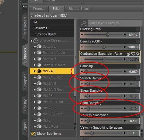

  • I have a few images, but have only transferred the images to a stick - should upload in 12 hours or so. Also look for damping, dynamic damping, shear & bend damping. Regards, Richard.

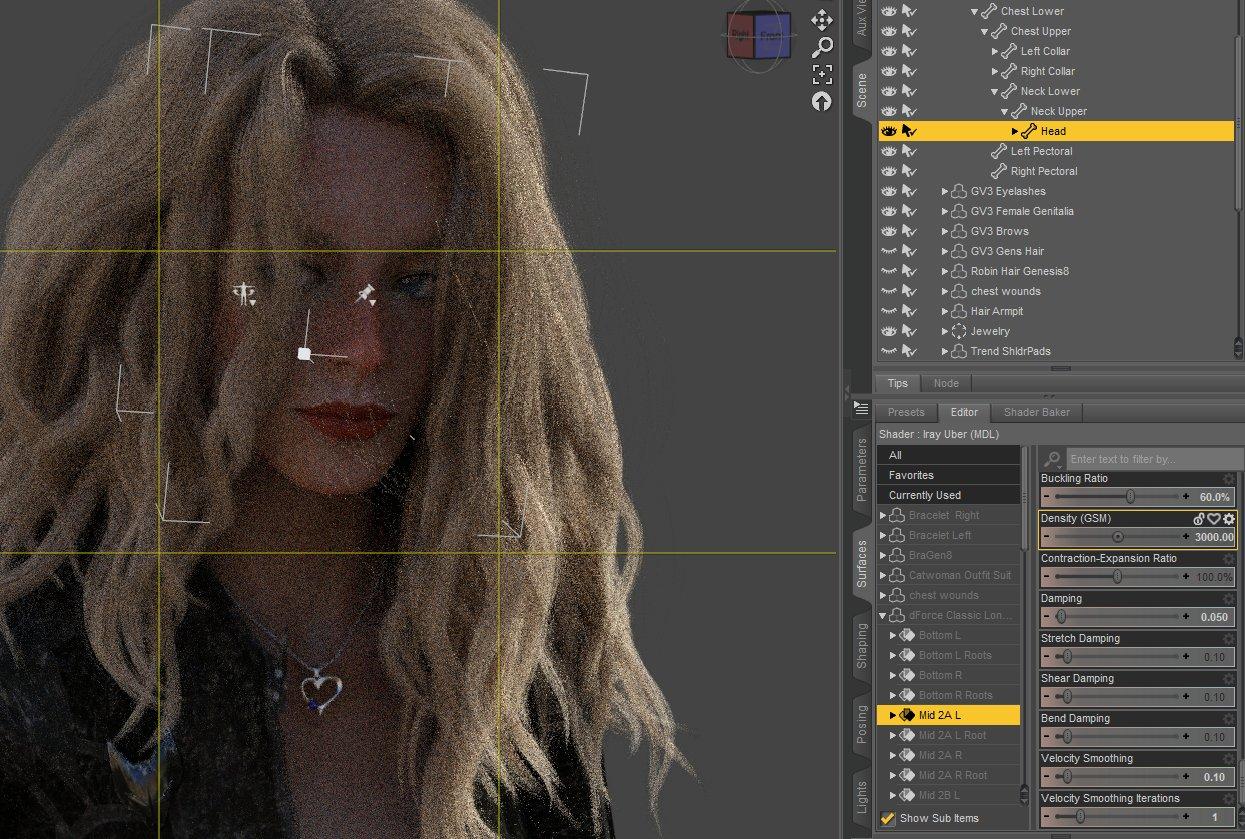

    The settings I think are pertinent are shown below using the example of the Linday 'Classic Long Wavy Hair'. Obviously, really only applicable to dForce fabric engine hair rather than the confusingly named dForce strand hair. If you're using dForce strand hair then I'm utterly lost with it.
    And after simulation (which didn't completely settle, but had very small movements between updates, I admit):
