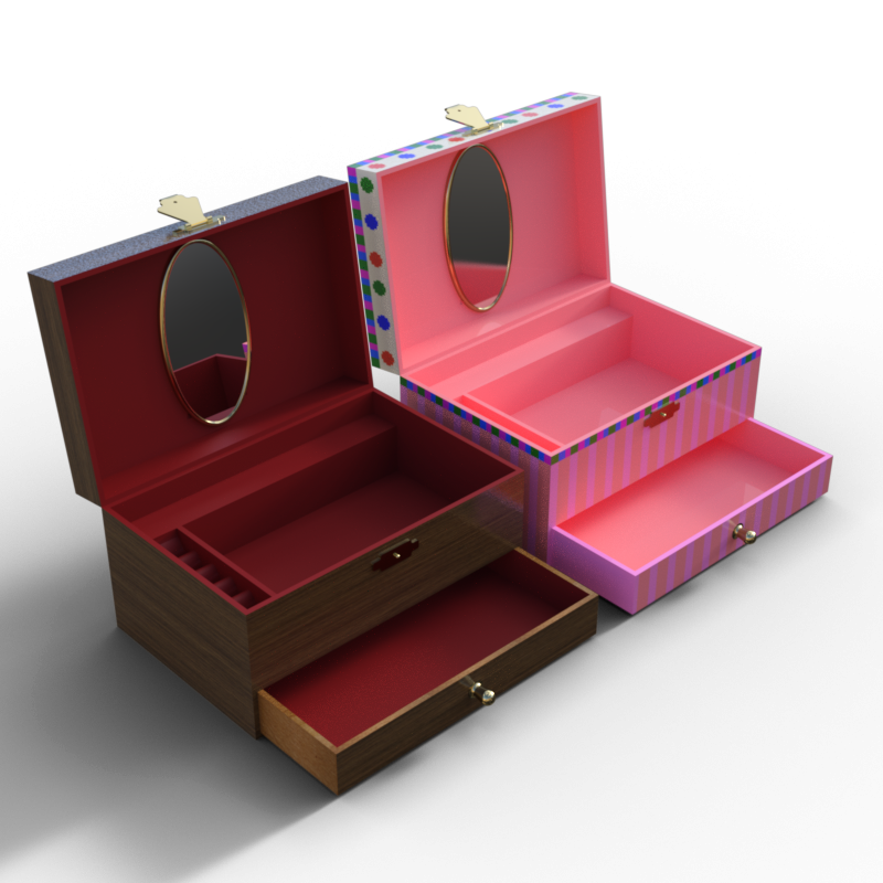

    All props/ figures in DS should be a single model file. Don't model as several model files if you can help it - that was a mistake I made when I started rigging models myself. When you do the rigging in DS is the point when you define how different parts of the model move relative to each other. If there is sliding or rotating motion relative to two separate bits of the model, unless there is an obvious hinge line along a facet edge, be sure the facets on each side of the joint share no vertices. This modelling feature is created in the obj file prior to importing into DS. In your modeller, if you can group parts of the model together with a group name, that will make the rigging easier. I have done a rigged jewellery box with opening lid, catch and sliding drawer. It seems logical to have four separate models (the catch, lid, body and drawer), but DS forces only one model file. The catch is one group. The lid is a second group, the body a third group and the drawer a fourth group. The rigging process in DS creates the bone hierarchy you expect to see in the scene tree. Regards, Richard.

  • It should come into DS as a single obj file. I'm really surprised it works as a saved scene asset when imported as several files as internally DS is supposed to keep track of them as separate models.
    The Jewellery Box I was referring to that I did was here: https://www.renderosity.com/freestuff/items/91116/jewellery-box-prop-corrected-zip
    Image:
    The actual obj file I used to get the model into DS is attached. You will see there are a number of groups as well as surfaces. The groups were used in that rigging process.
