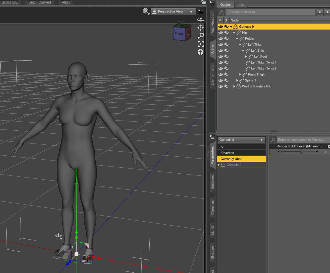

    I'm using 'Wedge Sandals for Genesis 9, 8 and 8.1 Female'. In this first screenshot, I fitted them manually to Genesis 9 (so no pose is applied):
    Then, I used the H.Pose and as you can see, Pose controls are now active:

    Then, I tried to save the pose as a H.pose, selecting Genesis 9 and using the default option:
    The created H.pose does nothing at all :(

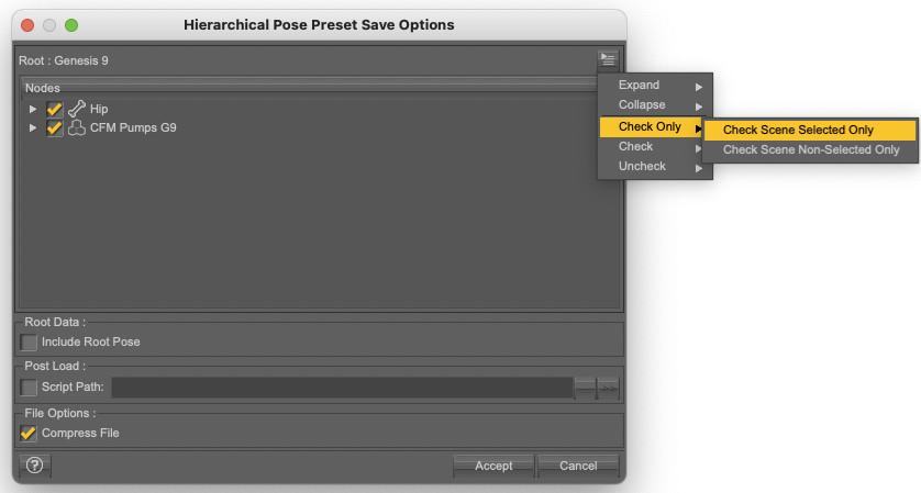

    The whole process I followed is:
    1. Select both feet then ask Daz to select their children
    2. Add Genesis 9 to the selected node
    3. Create a H.Pose preset using the default UI and asking it to check only the Scene Selected Nodes
    4. If you don't know how to un-archive .duf file, tell Daz to not compress it.
    Let's call it 'h.pose.duf'
    Keep it safe and sound, and then:
    1. Select Genesis 9
    2. Save a pose preset, first deselecting everything then re-select both feet.
    3. If you don't know how to un-archive .duf file, tell Daz to not compress it.
    Let's call it 'pose.duf'

    Ah, it didn't work ... because you left Include Root Pose option unchecked. Those Pose Control properties are on G9 which are "Root Pose" ~~
  • ElorElor Posts: 4,102
    edited October 2025
    The only video on that I saw about H.poses said to not check that because it would save information about the position of the figure.
    Checking it does save pose controls, but it'll save a lot of useless information about expressions and so on. And it does save the position of the figure, so using the h.pose saved this way will send the figure back to where it was when the h.pose was saved.
