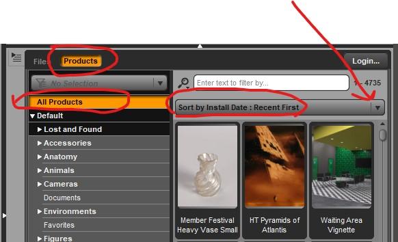

    edited October 2025
    In Daz Studio Smart Content, you can conveniently sort products my install date.
    582 x 354 - 53K
    Post edited by barbult on
