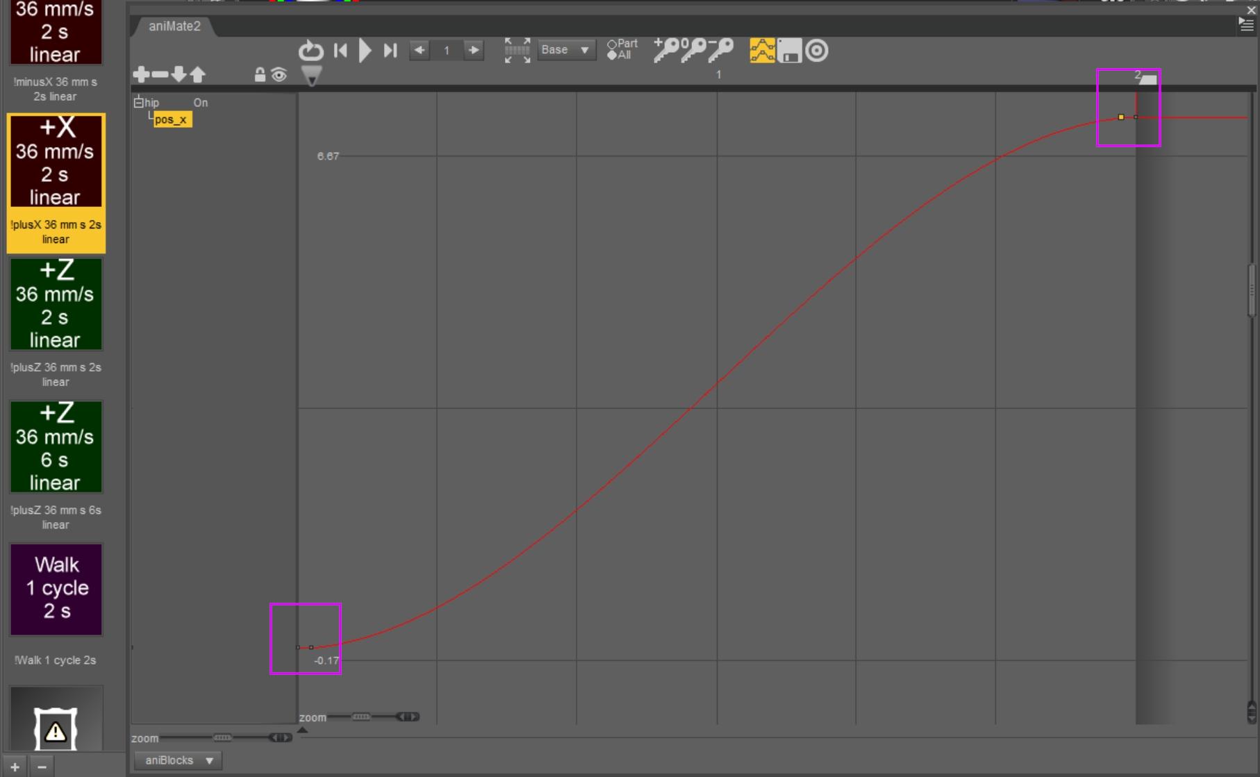

    aniMate2 Linear aniBlock, trying again.
    The goal here is to get a 2 seconds +X 36 mm/second LINEAR aniBlock move.

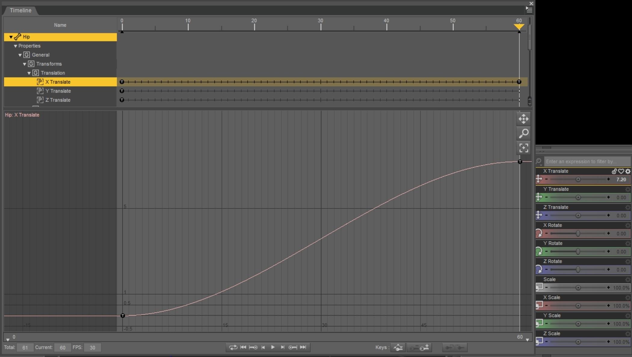

    Image 1: I create a 60 frames DS Timeline (2 seconds). On frame 60 I give a +7.2 (3.6 cm x 2) X Translate value.
    -This is meant to Create aniBlock from Studio Keyframes in the aniMate2 Tab.
    -I want a Linear move, I could change my DS Timeline keys settings to Linear but aniMate2 will ignore those settings.
    Image 2: I open the aniMate2 Tab and choosed Create aniBlock from Studio Keyframes (left click on the grey area where there is no button).
    -I get a nice TCB curve.
    Image 3: In the aniMate2 Tab, I add 2 keys, one a frame after the aniBlock zero frame, and one a frame before the aniBlock end frame.
    Image 4: Using the mouse, I carefully drag the new keys vertically until I obtain an ALMOST LINEAR curve.
    Image 5: You can see the very beginning of the curve is still TCB interpolated, but this shouldn't be noticeable during animation.
    -Actually the whole curve is still TCB interpolated.
    -I can now rename my new pseudo linear aniBlock and save it as new.
    Testing the Bake To Studio Keyframes utility:
    Image 6: Here I baked my new aniBlock to Studio Keyframes (left click on the grey area where there is no button).
    -Notice that Key 0 was set to Constant interpolation (bug or feature?).
    Image 7: I can select all X Translate Keys and set them to Linear, TCB or Constant interpolation.
    Image 8: All X Translate Keys are set to Linear interpolation. I save the Timeline as a Pose preset, clear the Timeline and clear aniMate2.
    Image 9: I loaded my new Pose Preset to the DS Timeline, and in aniMate2 I choosed Create aniBlock From Studio Keyframes to see what happens.
    -Not what I expected, but at least I can save  this aniBlock as a "Smooth Start" for my figure moves!
