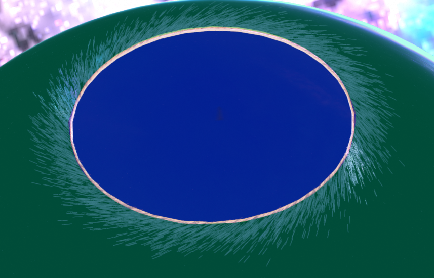

    - I am using the Strange Set (so the circular shape portal), but I would like it to be inclined, like that:
    To do that, I just dialed the rotation parameter settings. However, here, we can only see the sky; I would like to see the landscape.

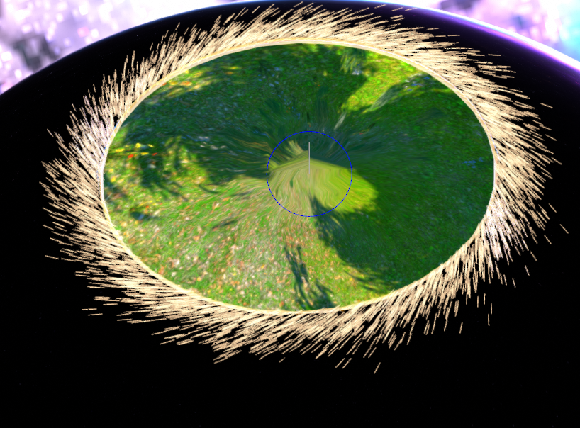

    So, in the surface settings of the "HDRI Here" part of the portal, I dialed the horizontal and vertical offsets, because it's the only way I found to move the HDRI image in the portal. (I am using the environnement 010 which comes with the portal product).
    However, the image become hugely deformed, that is not at all what I wanted:
    So, I'm quite surprise: isn't there any way to move the HDRI image in the portal without deforming it?

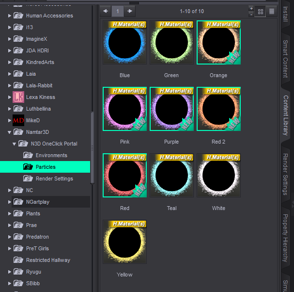

    - @markusmatern Could you tell me how you did to create this smoke effect around the portal, please? I find only these settings among its materials, and none of them looks like smoke...
    Thank you in advance for your help!

    I'm pretty sure just changing the horizontal or vertical offset in the tiling is not enough. The UV map of the inner part of the portal sphere basically uses a distorted form of a Equirectangular projection.
    For such a projection it is not sufficient to just change the offsets. You need something like the free software Hugin specifically to change the projection of the image map fitting the rotation values of the mapped HDRI.
    To answer your question: There is no eassy way to change the rotation of the inside sphere except only using the horizontal offset, which rotates the sphere. However you would need tilting for your example, which does not work by modifying the vertical offset, because of the Equirectangulat projection of the HDRI.
    The smoke effect is from a product no longer available at the DAZ store. It had various smoke rings in VDB format in it. Now there is MMX VDB Portals, but I don't own it.
    The basic workflow I mentioned above however should wotk with this, too. I'll try to elaborate more later on....
