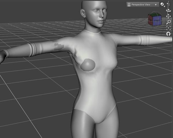

I do not try with other figure shape, but when you auto-fit gloves for V4 to genesis,
and you use other character morph, Auto-fit do not work well.
first I think there is problem of my morph, but if I set default female, or male FBM to genesis,
the right gloves gravitated toward left arms. so the shape corrupted.
first I check all weight-map, and try to mirroer weight, but it could not be corrected.
then I check node with joint editor,
I found ,the Left arm mesh boundary is obviously wrong.
so if you use auto-fit with gloves for V4 , it is better to use another template .
I recommend not check any template (eg shirts or body suits not so good for gloves) for gloves
just auto-fit without template.(of course you need set-clone type)
1091 x 724 - 112K

    The problem is the auto-grouping function used by both autofit & the transfer utility, it's making a mess of transferring the grouping from the templates to the converted mesh, the grouping transfer is bad with all templates, even when you use Genesis as a template, but the distortions only seem to happen with a couple of them, in my case the Bodysuit tight template.
    The image is a V4 leotard I autofitted (I also tried it with the Transfer utility), dial up any morph and the right side distorts. As well as it's own polygons the right collar also has polygons assigned to it from the hip, right thigh, left thigh, neck, left shoulder, left forearm and left hand.
    I redid the face grouping with the Polygon Group Editor and now that outfit works like it should, it no longer tries to pull to the center when you dial a morph, which I believe is what's happening to you.

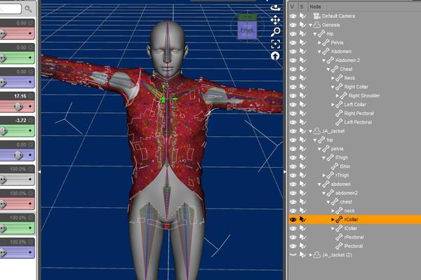

    aa,,, ,,,,,,,,,,,,,,,,,,
    when use "shut template", there is prolbem about r-coller too,, :blank:
    the clothings with default template (that means no -type, so remain many bones)
    it seems not have any problem about r-sholder too.
    (I am angry now,,)
    it is better to use auto-fit or transfer utility with non-template.
    I remake now,, from my obj and transfer utility.
    bejay said same problem? or not?
    847 x 688 - 99K
    866 x 576 - 81K

    mm,, I checked the poligon group,, but I coul not find the difference,,
    it seems keep synmetry assigend,,, uu,,,, is there many case about the problem?? ^^;
    though as you said, I sometimes felt strange, why I need reshape again by hexagon,,
    so I thought I forgot to check mirroer ,, but it seems the problem about tranfer utility ,,
    I am angry,, a little ^^;

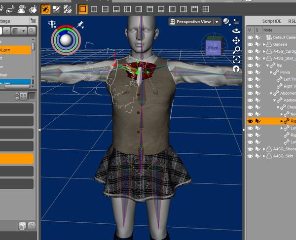

    The distortion only happens from using some of the templates, but others have really bad grouping without the distortion. Take your picture of the A4 SchoolGirl shirt, I can see from the pic that the right collar has polygons assigned to it from all over the mesh, but I know this doesn't distort as I have this outfit and have already fixed the wayward grouping on it ;)
    As to why only some distort, at a guess I'd say it's down to how spread out the grouping is, my leotard's wayward grouping was mostly in the crotch and left arm, so it got pulled in those directions, the A4 SchoolGirl shirt has wayward grouping in both arms and torso, so the mesh isn't being pulled as left & right will cancel each other out, regroup the right arm and it probably would distort.

    as you say first pic is auto-fit with template shut. it caused not big distortion,
    but when I pose hand, there were big poke , so I felt strange,.
    then,, I understand about first pic,
    " the right collar has polygons assigned to it from all over the mesh"

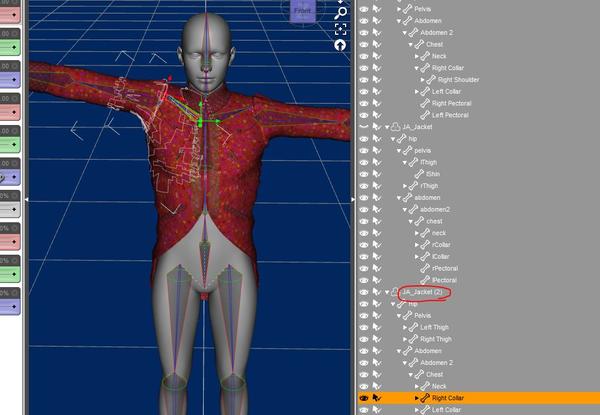

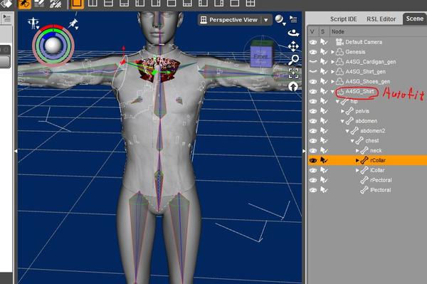

    then second pic is which I replaced the obj of auto-fited figure but with no template,
    I saved the reshaped obj for fit genesis shape more , so I use the obj and replace obj only by transfer utility .
    so the rig and poligon assinments must be same as when I auto-fit but with non template.
    Now I seems the second pic figure poligon assinged correctly from the picture..
    anyway,, I relieve , because you say , assign group correctry again, I can deslove the problem
    when I found same problem.(but it is not auto-fit at-all ^^;)
    now I test it as two auto-fitted figure .
    a) jacket auto fit to genesis with "shirt" type
    b) jacket auto fit to genesis with "no" type
    the product is jaggler jacket for v4
    there can not find any difference usually with zero pose, zero morph.
    but when check node and mesh bounary,
    the a) auto-fitted clothing mesh boundary toward all body.
    next I bend the r cloller,, some degree.
    the a) figure make so big poke through,,,,not only r sholder , l sholder too. aatemp1 img
    but b) figure can follow the pose. aatemp2 img
    (edited so,, in this case,
    the problem is happen with shirt template . otherwise no type,(default template) auto-fit do not make poke through)
    1019 x 704 - 98K
    951 x 633 - 104K
    Post edited by kitakoredaz on
  • kitakoredazkitakoredaz Posts: 3,526
    bejay as you said,, the group must messed up when use some "type" template.
    I think which template use decide where the group messed up,,
    so if use v4 bodysuit for auto-fit with every type, and check by joint editor,
    I can find where face group messde up with each type.
    I will test again with transfer utlity,,not use auto-fit figure with non projection template,,
    I hope non-type option can remove this problem,,)
