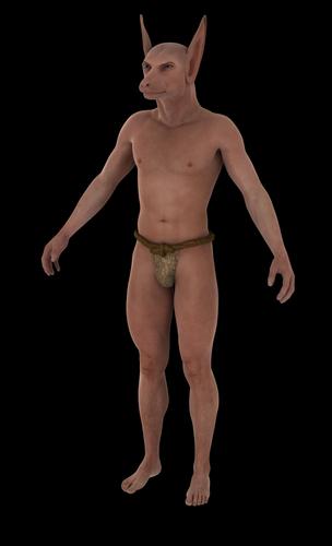

    image below is M5 with Anubis Head applied...
    800 x 1317 - 188K
  • gabugabu Posts: 303
    That image is exactly what I had in mind (I got the idea from David's avatar in the film '.Hack, the Movie').
    However I had a more general question of whether any selected genesis body part could take the shape/morph from another genesis figure's corresponding body part - a bit like some mad scientist/Frankenstein creating a monster/chimera from bits of different characters. The flexibility of genesis should make this possible. So I was wondering whether DS4.5 would enable that to be done but it looks like it hasn't got quite that far yet. It looks like the contributing bodies have to have explicitly enabled their morphs to be used like that, as with the Anubis character giving the options of just the head or legs able to be used.
