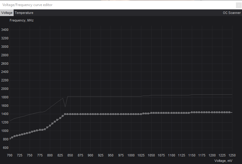

  • WendyLuvsCatzWendyLuvsCatz Posts: 41,813
    edited September 2025
    is your PSU powerful enough for your GPU?
    mine isn't and if I don't undervolt with MSI Afterburner it will blackscreen when I render
    I level out my board power draw curve so it never reaches 300W in GPU-Z because that's when it will crash
    it will vary depending on how many volts your PSU is, it took me quite a few goes and crashes to find my "sweet spot"
    I don't know my PSU voltage and cannot open my tower up easily to look (memory like a sieve cannot recall what it was last time I checked)
    800 x 542 - 21K
