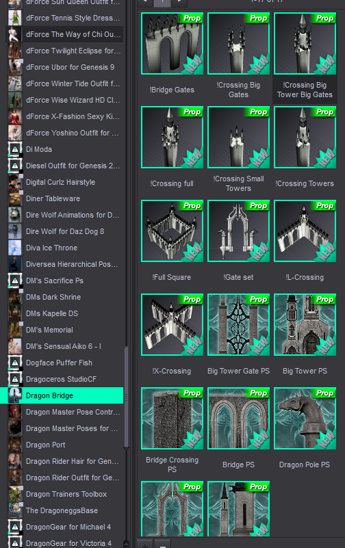

Hi, I bought and the Dragon Bridge (https://www.daz3d.com/dragon-bridge) and I installed it by DIM, but I would like to use it in DS, and I don't find it in the Smart Content or the Content Library. In the Content Library, I went to Products, and I searched for "Dragon Bridge", but I didn't find it... Could you tell me if you know where I could find it, please?
Thank you in advance!
  • ElorElor Posts: 4,255
    Hello,
    It's likely in your Poser Library, considering how old it is.
    So try to look at 'My DAZ 3D Library' in Poser Formats and everything should be here (where I don't know, I don't have it and the way Poser organizes its files doesn't make any sense to me).

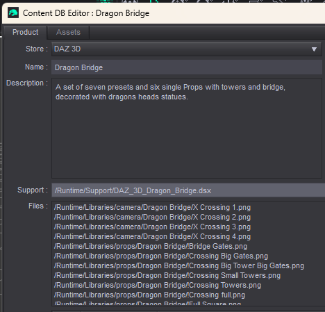

  • Ah, ok, thank you very much! I found the props on the props section (that is normal!) and the cameras in the cameras section. In order to make it more convinient, I would like to create a product from them, but I am not sure how to do it, when the items are located in several different sections: usually, I just click on the folder and do "Create a product from", but since there are 2 folders with the name "Dragon Bridge", but in 2 different sections, I am not sure how to do... Can I select one of them and do "Create a product from", and add the items from the other folders afterward?
  • Create your product in the usual way and seelct it in the Content Library>Products. From the Content Library pane option menu select Content DB Editor. You can now add files by right-click in the Files area on the Product tab, and edit other metadata in the Assets tab. There is an option to add recursively, so you would need to select only the root folders.
    Another option would be to install the product to an otherwise empty content directory and use the create from folder or the add ecursively option in the editor to grab everything at one go.

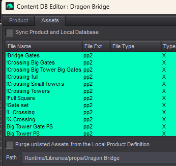

  • Thank you very much! I tried but the cameras don't appear on the product folder or the Asset section of the Content DB Editor, though they appear in its files section:
    Is there something that I misunderstood? Thank you in advance!

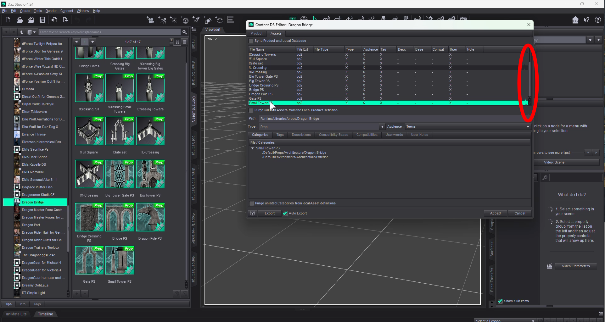

  • felisfelis Posts: 6,635
    I would expect a scroll bar to the right, but you have cut your image before that.
  • Ah, maybe I cut a bit too close, sorry about that... To be sure you can see everything, I made a short video showing clearly how it looks like. You can find the video on Workupload: https://workupload.com/file/zJfYXhsVMXT
    edited September 2025
    The red cirkle mark a scrollbar.
    1923 x 1024 - 1M
    Post edited by felis on
  • Sorry if there is any misunderstanding, but on the video, we can see that the scrollbar has nothing to do with that, since the presets in the camera folder don't appear at all in the preduct section (even if I move the scrollbar!), though they appear in the files section of the content DB editor...
