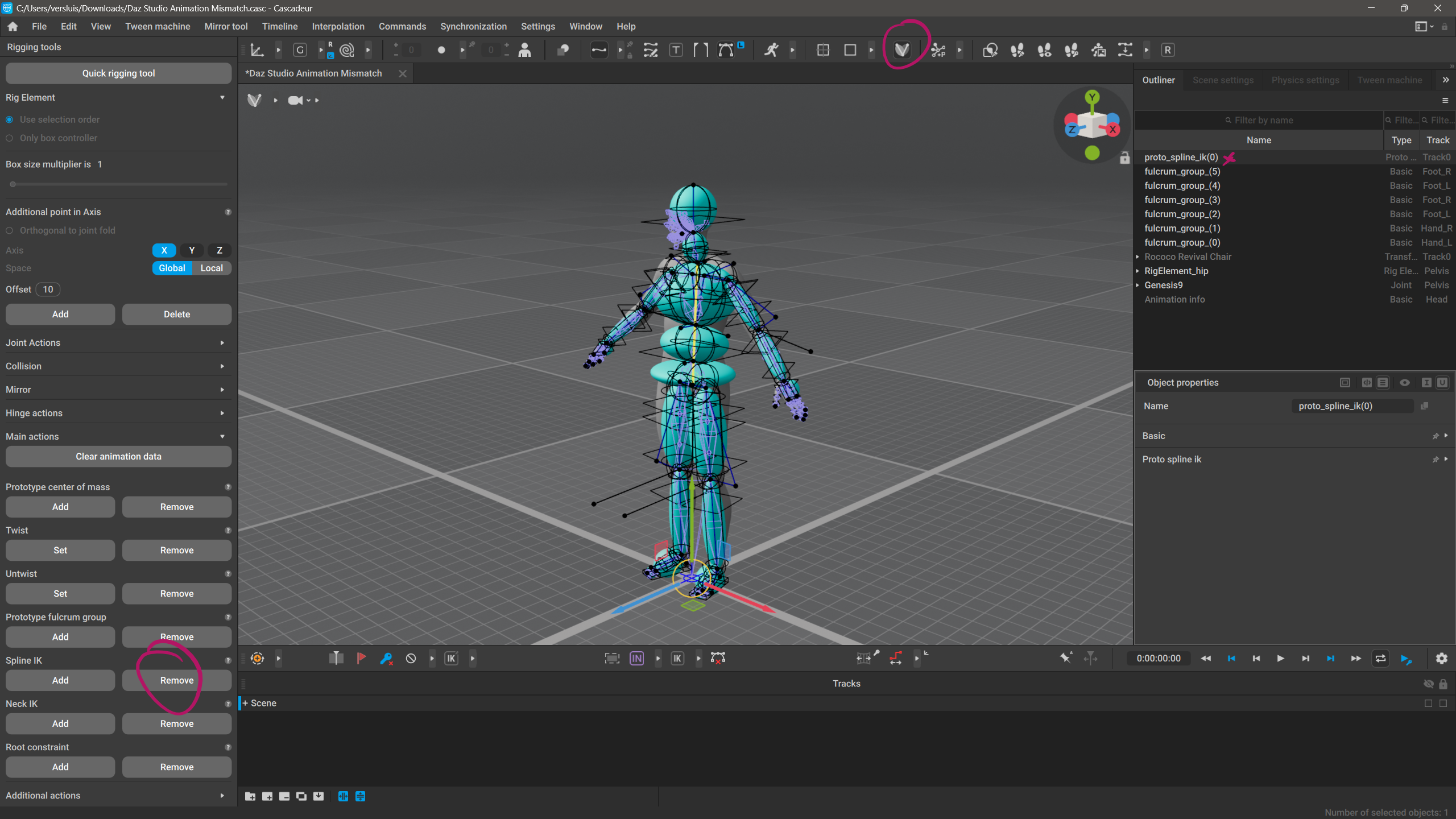

  • Jay VersluisJay Versluis Posts: 269
    Try disabling the Proto Spline IK object in rigging mode. With that disabled, the animations work perfectly when exporting back into Daz Studio. I had the same problem until Sdueq on the Cascadeur Discrod pointed me in the right direction.
    I've made a video about the whole process (export from Daz Studio, animate in Cascadeur, bring back into Daz Studio). It goes public next week: https://youtu.be/Q_8ItvGZo5Y
