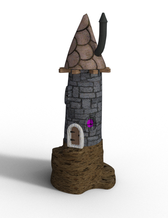

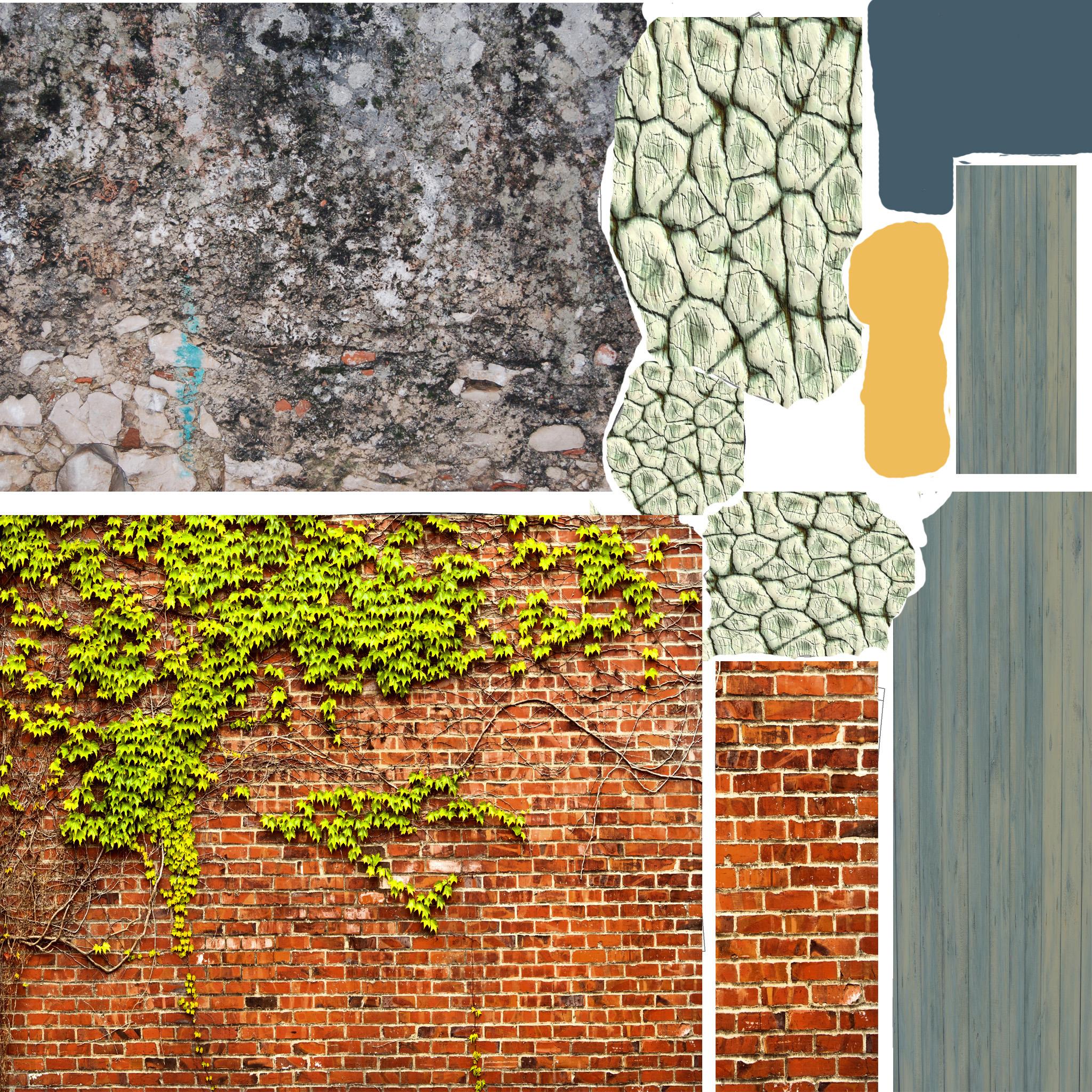

    Woot I did it!  lol.  Some mistakes but since I did this in 15 min with my mouse and not my tablet (its almost bedtime and I couldn't wait another day to at least attempt it) but I totally understand now how its done.  Oh my this is going to open up a whole new world. Apparently you can't paint the color you want something to be?  I painted the window light yellow and the metal door pieces a steel blue but they don't show in the finished render.  Also, once I added the tower to studio I was unable to move it in any direction.  Is that normal?
    Sonja, that is terrific! I love the vines on the brick, and the large rocks on the roof. And that took all of 15 minutes? Impressive. Just think how cool it will be if you spent a whole hour on it, lol.
    As to why the windows and metal parts are not showing the correct colors, that is strange. They should be the colors you had on your texture map. Check the surfaces tab to make sure that you have the texture map showing in the base color for those surfaces, and that there is not a different color sitting in there. The model had some colors saved in it by default to show the different material zones. It is also not normal for the thing to not move. Mine functions like any other prop and can be moved, rotated, and scaled. Weren't you having some other sort of DS issues recently? I wonder if that is related.
    Thanks so much for showing your work.

    edited April 2016
    Yes I have been having some odd things happen with textures but nothing with objects.  And only with double clicking not with adding a them in any other way.  But who knows.  this is what I did maybe I did something wrong? Each texture is on a separate layer and the blue and the gold are painted on a separate layer as well.
    2048 x 2048 - 2M

    Yeah Sonja, that looks fabulous. I like the different textures you came up with. Did you check the surfaces tab to see if there is a stray color in there? It has to be coming from someplace.

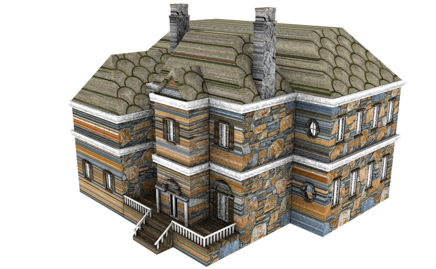

    I am having a texture problem with a house I am trying to texture lordy I am about to pull every last hair out I have!!!!
    Plz tell me what the heck I am doing wrong!!

    It looks like the textures are being planar projected - that is, projected from one direction (the right side in this case), which means they will be flat on two sides and stretched out on the others. The result is nice textures on any polygons that perfectly aligned with the projection axis and distorted textures on the others, getting worse the more perpendicular to the projection axis they are.
    If you look at the two Carrara screenshots attached, I created a basic shape kind of vaguely like your building.  In one I unwrapped it using a planar projection in the Y axis.  Notice that the selected polygons all show up as just a thin line on the UV map... when a texture is applied it will stretch crazily in that area because the renderer will be trying to fill all those polys with just a few pixels of the texture.  In the other image I used a cubic projection for the unwrap, which splits polys according to what direction they are facing.  The latter will give a much better result when applying a tiling texture to it.
    I think you need to take it into a program with the ability to create/edit UV maps (Carrara, Hexagon, Blender, one of the many dedicated UV mapping programs out there, etc.) and unwrap it more carefully.  Ideally you would add seams and do a more detailed unwrap so that your texture matches up where different sections meet up, but that takes some time and is kind of an art to itself, so for simplicity's sake you could try a cubic/box projection. You'll still get a little distortion on the angled surfaces but it might not be too bad, certainly not as bad as it is now.
    Of course it might not be a UV problem if you are using a program that allows you to apply textures in ways that ignore the UVs.  For example, Carrara gives the option to apply textures via planar or cubic projection within the shader regardless of how the UVs are set up.  But I think it's probably the UVs.
    If you let us know what program(s) you are using for this, people might be able to provide more specific help. laugh

  • Richard HaseltineRichard Haseltine Posts: 111,718
    It doesn't have any textures, it is UV mapped - badly, as MDO2010 says just a single planar projection so the side walls and roofs are a line on the map instead of polygons and when you apply textures it simply stretches a single column or row of polygons across those surfaces. Since the terms of use don't allow redistribution no-one can remap them for you so you would need to do the job yourself, or perhaps try the Shades of Life shaders on them if you are rendering in 3delight.
