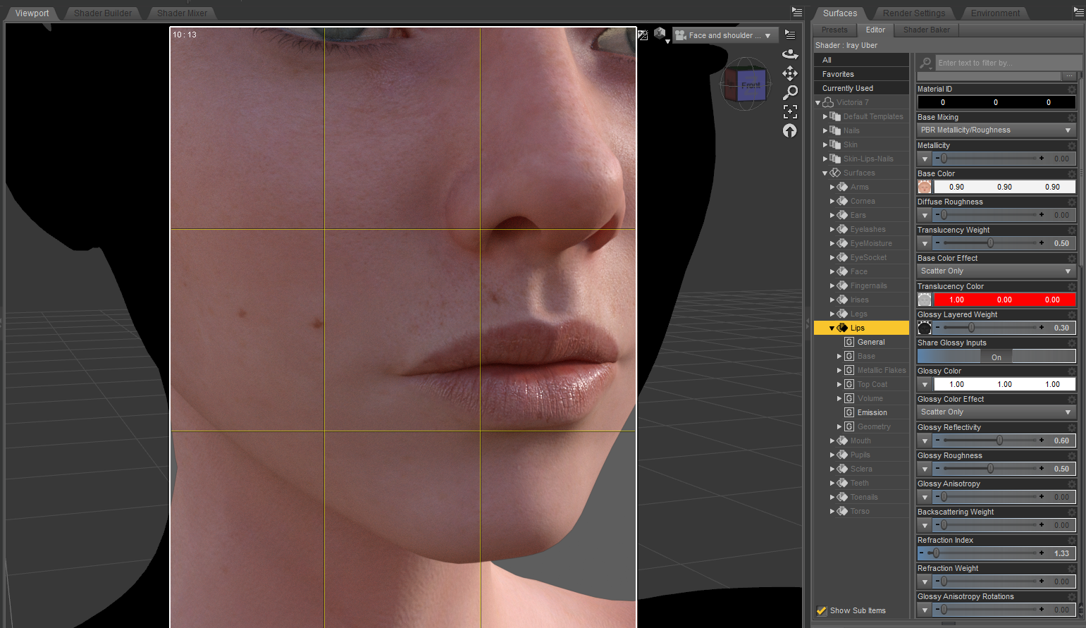

Can anyone tell me why I cannot seem to get light color lips on Cailin? I have her default lips03 selected which are just aboout the lightest shade of lips she has and yet they show up so dark regardless of the lighting. I have no make up selected so I am just at a loss as to why the lips always seems to show up as such a dark shade that do not seem to match what I have selected. I would like something flesh colored pink and light, a no lip stick look Essentially how it looks on the example. What am i doing wrong? I have double checked to make sure it is the Iray version. Please help!

  • PetercatPetercat Posts: 2,324
    How does the render look? The lips might appear lighter in iray.
  • the pic on the right is a low res render in iray...
    Can you post a screenshot of the Surface settings for the lips (the rest of the skin looks a bit off, too...but let's just concentrate on the lips for now).

    These are the settings for the lips that loaded as deafault, I did not change anything.
    For the skin settings I simply copied the settings I found here (http://toyen-art.deviantart.com/art/Daz-Studio-Iray-Skin-Shader-Settings-Outdated-532976349) but I am open to suggestions. I like very fair skin. In fact the default skin that comes with Cailin is far more fair than what I created with those settings but I did want to create a bit of shine and lighting depth if that makes sense. I did alter one parameter that did seem to make a difference which was the Transluceny Color, which I set at 1. - 1. -1. or all white to get rid of the pinkish hue.

    Setting the translucency at 1 is the reason for the red lips  - Generally Cailin renders quite well out of the box and messing around with the Glossy settings can give her skin more sheen but If you like to do a lot of changing skin settings for models  then a great product to get you where you want quickly is Iray Smart Converter

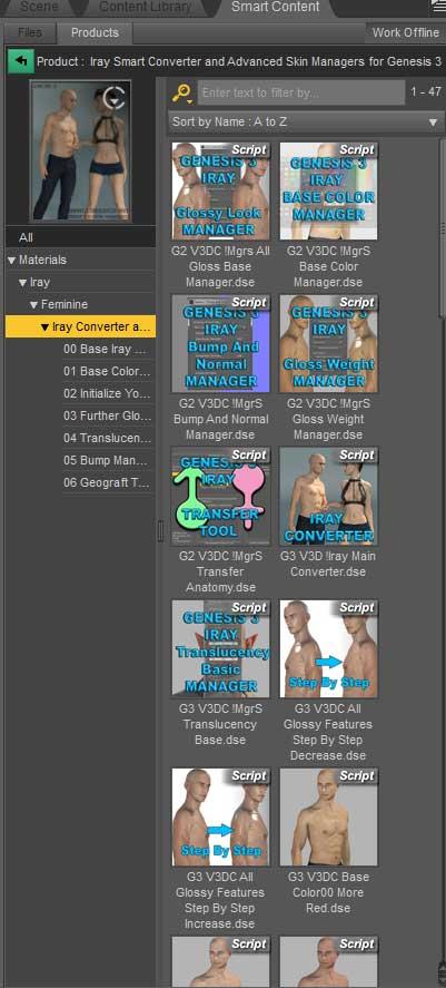

    So I have purchased Smart Converter and loaded it and restarted Daz...my question is, where are the controlling parameters for it? Hah, silly question as it is, I can't seem to find it. Surfaces...smart content...please help! Thnx :)
    Post edited by OminousAutumn on
  • OK I think i found it in Smart Conent :p
  • I am definitely finding these a bit confusing. Not noticing a difference when i double click. You mentioned a forum/chat? Is there an online manual of any sort? I think I definitely need some direction/tutorial on how to apply/use these for Mac. Any help would be greatly appreciated. Cheers!
  • TottallouTottallou Posts: 555
    edited March 2016
    I installed with Dim & for that it is under People - Genesis3
    I checked Smart Content & it seems to be under - Materials - Iray- Feminine (even though it works on the guys to:)

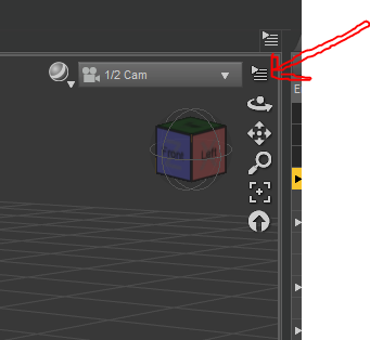

    Hi can you tell me how you got the divisions on your viewport?  That's is the first time I have seen that in a post, is it included in DS or a separate purchase?
    edited March 2016
    Its not a seperate purchase its hidden in Daz  - You just click on the arrow/bars next to the Camera  then check  "Show Thirds Guide"  from the drop down that comes up.
    I added a screenshot so you can see where I mean
