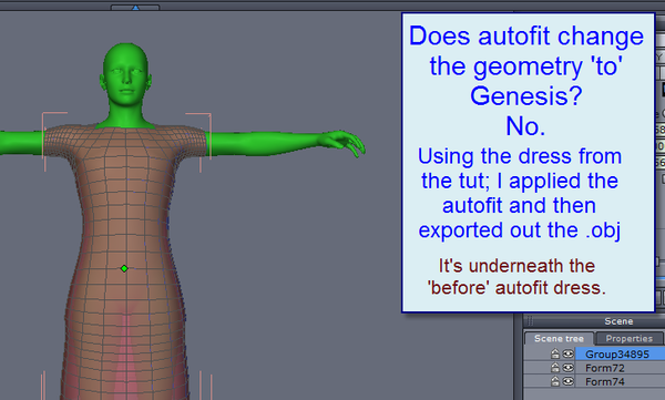

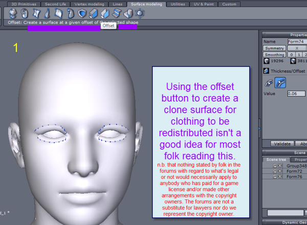

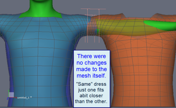

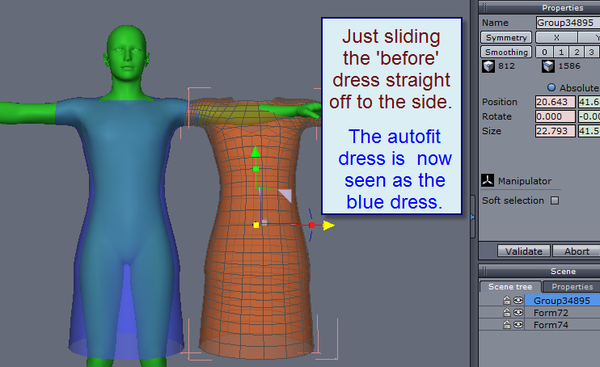

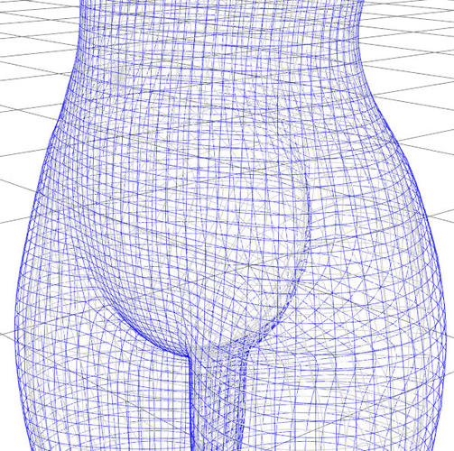

    I put numbers on the images in case they don't line up correctly.
    Concerning legalities and what other people may or not be doing; let's remember too that not everybody is in the same ballpark. Some people may have paid mega dollars for licensed privileges which may have included redistributing mesh [as in for games].
    Since I happened to have a mesh hanging around from that tutorial; made good use of it to check out the autofit question. [wondering why didn't I think of that, it's a great idea!]
    Good news based on one test, it does NOT change the mesh itself into that of Genesis'. So yes, why not, we can use that AFAIK. [this comment may stand to be corrected by Daz3d if they so choose ;-) ]
    5 images per post so this will take a minute to load them all in.

    800 x 585 - 225K
    edited September 2012
    These pictures have numbers in their name if they should happen to line up out of order.
    794 x 519 - 113K
    594 x 364 - 132K
    742 x 454 - 103K
    728 x 438 - 71K
    Post edited by patience55 on

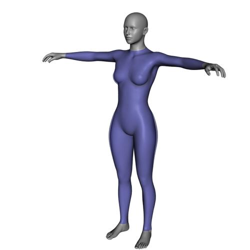

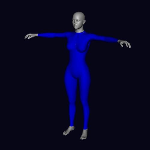

    What I have done here, is import my bodysuit mesh obj into Daz. The first image is the raw import. The second image, my suit after running it through the transfer utility and adding the smoothing modifier. The third, the suit set to about 50% opacity which does show it is not super tight fitting, but until I look more closely, this might be errors in my original mesh or it might be the transfer and smoothing doing this. Some areas are very tight, like the back, but hips and breasts are a bit loose (although one could argue as a good thing). Image 4 is the mesh, mine in blue over Genesis in gray. Obviously, like Patience found, the mesh did not attach to Genesis nor rearrange vertices to match/copy the Genesis mesh.
    Very Nice and thanks Graham for bringing up this in your original post. I suppose I hijacked your thread though... :( Sorry about that.
    Anyway, if this is good with Daz, this could by a huge timesaver vs. pulling/pushing all of those vertices around in Hex!
    596 x 593 - 252K
    600 x 600 - 47K
    600 x 600 - 31K
    600 x 600 - 68K

    You're right Gedd... Here is a copy of my question... Hope it is clear enough...
    We have a discussion running on the Hexagon forum where this question came up. We wish to know if it is legal to do the following for public use.
    1. Create a new mesh in Hexagon not using any of the Genesis geometry.
    2. Save this to a obj.
    3. Import the obj into Daz Studio.
    4. Use one of the tools to fit your new mesh to Genesis, such as the transfer utility and smoothing modifier.
    5. Export your mesh back out as an obj. or send to Hex.
    6. Continue working on your personal mesh which now has been smoothed and fit via Daz Studio.
    7. Use this mesh for public release.
    When doing this, We do not see that any of the geometry from Genesis is being matched to the 'new mesh' geometry, but that the mesh is simply smoothed and perhaps moved in or out to better fit Genesis. The 'new mesh' is also not really shrinkwrapped to Genesis, as there is an offset in the smoothing.
    The thread topic is located at:
    http://www.daz3d.com/forums/viewreply/98572/
    There are several images showing the process within the thread.
    Also, I have been talking about Genesis, but would like to know if the same is true for any of the Daz figures?
