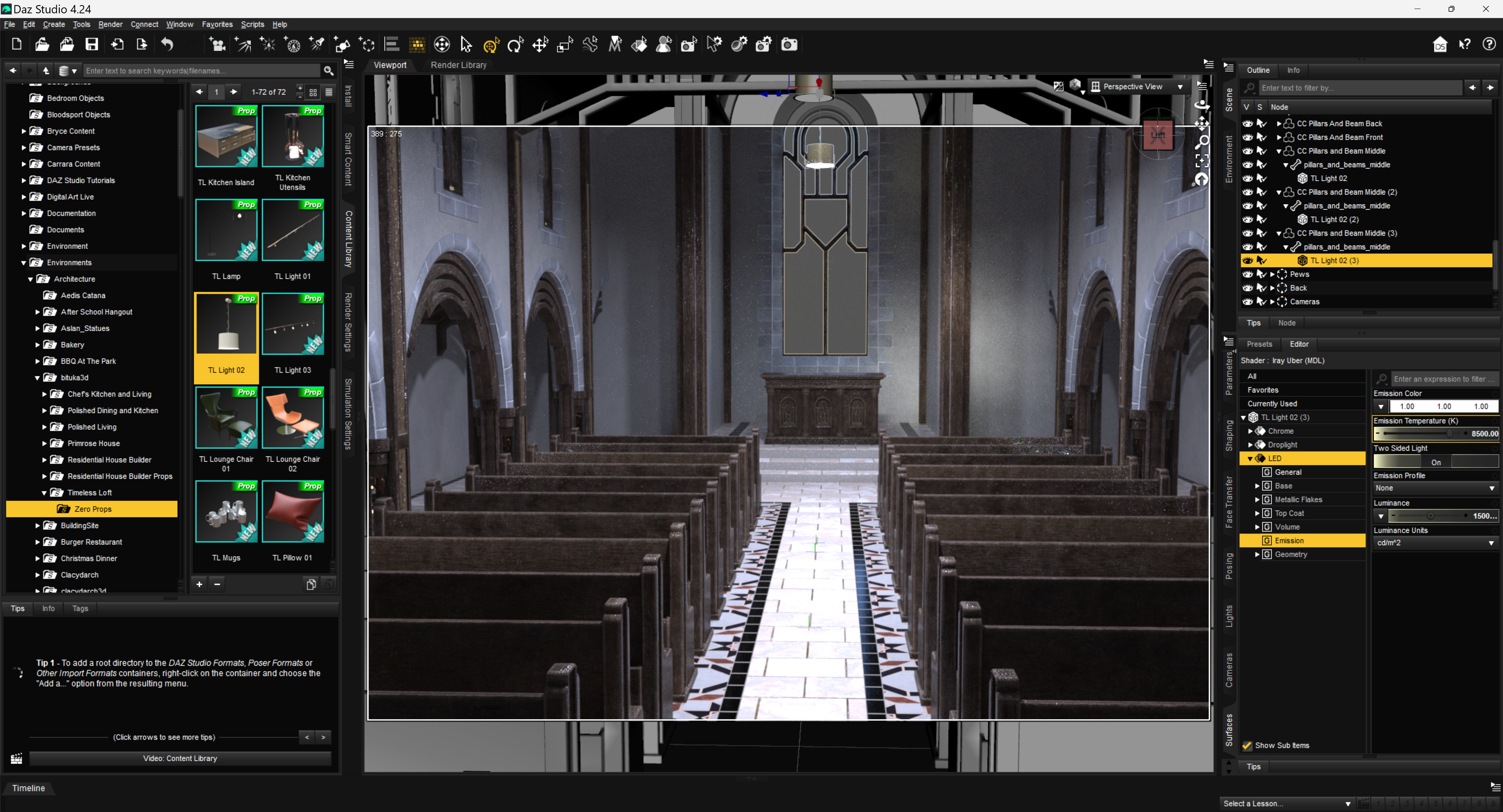

Hello, I got this environment for my next task.
At least, this one has structures near the ceiling to hold some Lighting props.
Unlike the Romanesque Chapel https://www.daz3d.com/romanesque-chapel, which I had asked for help in this thread https://www.daz3d.com/forums/discussion/739531/i-am-looking-for-a-construction-beam-prop#latest where the lack for some structures to hold the lighting are missing, and I wanted to add something similar like the below environment.
The Cornerstone Church https://www.daz3d.com/cornerstone-church available in the store.
It consist of a Day and Night scene.
You will notice the difference, as I added some props that give more lighting.
I have an issue.
The night scene (it can happen with the Day scene as well), I want to add a background to be seen through the window.
The glass is not transparent, any ideas how to make it transparent surface?
Your help is appreciated, thanks beforehand.

  • felisfelis Posts: 6,642
    If the window has its own surface, then you can just apply a glass shader to it.
    Be aware that 'thin walled' property in Surface settings should be 'yes'.
  • crosswindcrosswind Posts: 10,358
    edited August 2025
    You can hit Alt Shift + M to switch to Surface Selection tool. Go to Surfaces pane, then hover the mouse cursor to that window glass, and select it. You should be able to have the glass surface selected.
    Check if Refraction Weight is set to 1.0... If it is, it's just transparent. If it's not, set it to 0. (To test it, you can simply place whatever a Prop near the outer side of the glass, you should be able to see it thru...)
    Then add an HDRI or whatever a background image that you like ~~
    Post edited by crosswind on
  • If you do not want a refraction effect, you can set "Cutout Opacity" to zero.

  • Hello guys, sorry to not have answered to you, because I am working on a project that takes time to get done.
    I have tried your suggestions.
    felis said to apply a glass shader, it would mean to find any product that may contain a shader for the windows glass
    crosswind told me to check for Refraction Weight, I did that, still the window glass looked same.
    The Alt, Shift+M keystroke is a cool thing.
    nakamuram002 you said to use Cutout Opacity set 0, this worked nice for what I need
    Thanks to all of you.

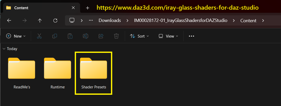

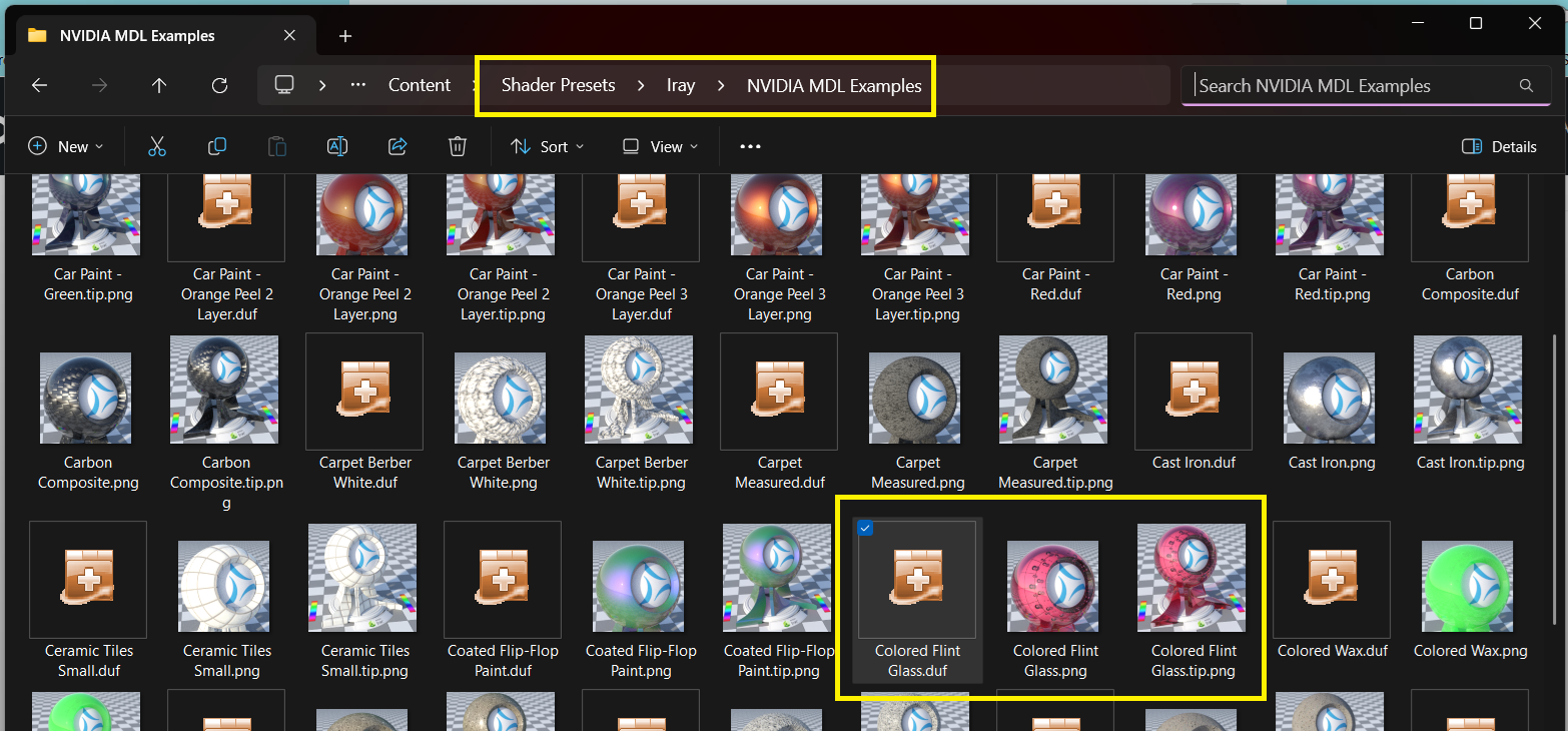

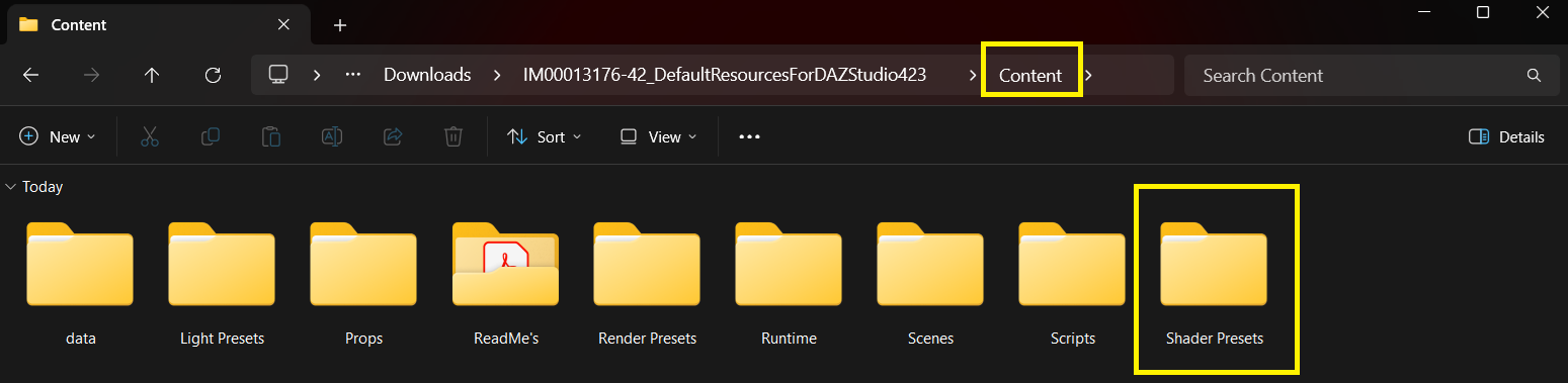

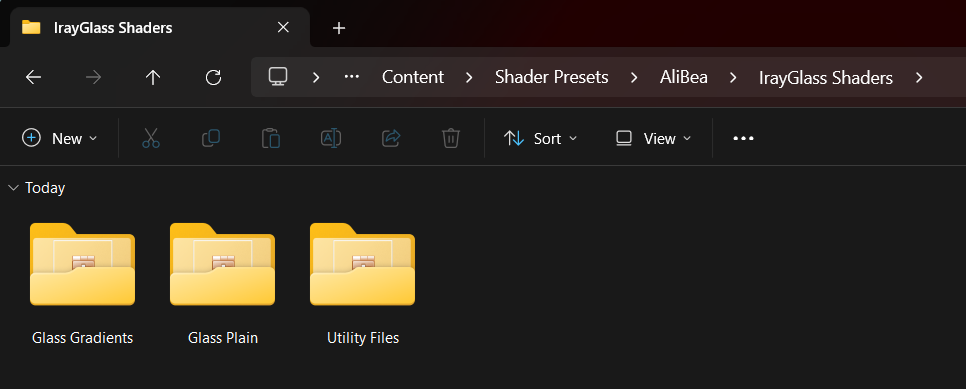

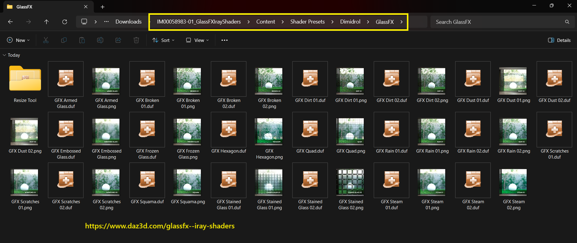

    Then let's find some shaders. In the default stuff that came with the program, yes there are shaders but not too much for glass. Checking for Iray shaders I found this one.
    Then took a look at a couple of purchased products and found where they are kept.
    So in the Content Pane of D/S, one follows the trail of nested folders to reach the desired collection.
    https://www.daz3d.com/glassfx--iray-shaders  [only $1.99 atm]
    https://www.daz3d.com/iray-glass-shaders-for-daz-studio
    https://www.daz3d.com/catalogsearch/result?q=iray+glass+shaders   oodles available for purchase, some are on sale, some will be one day.

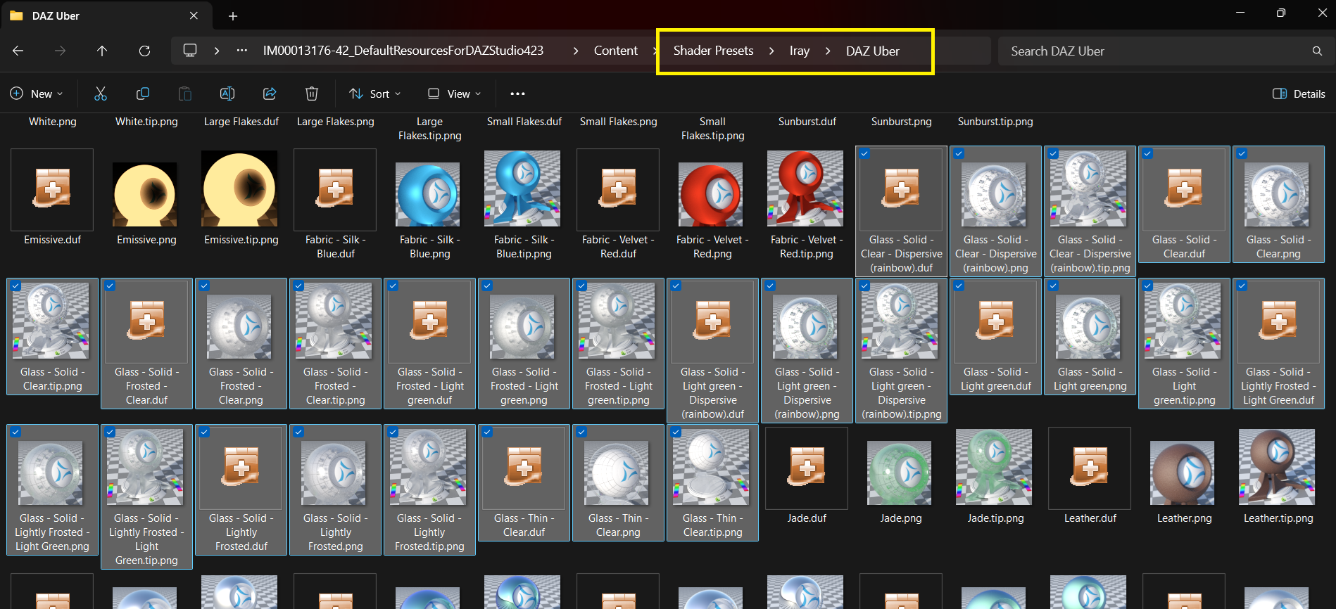

    There is a number of glass shaders in default ressources.
    edited August 2025
    You know, I search for "glass" under Iray [in W11] and apparently it had hidden other results. Joys of having poor vision. So I clicked on the option to show more and wow! Yes -- there are more!
    1898 x 866 - 862K
    Post edited by Catherine3678ab on
