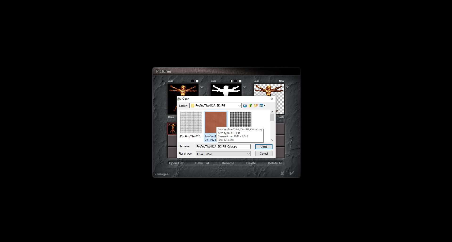

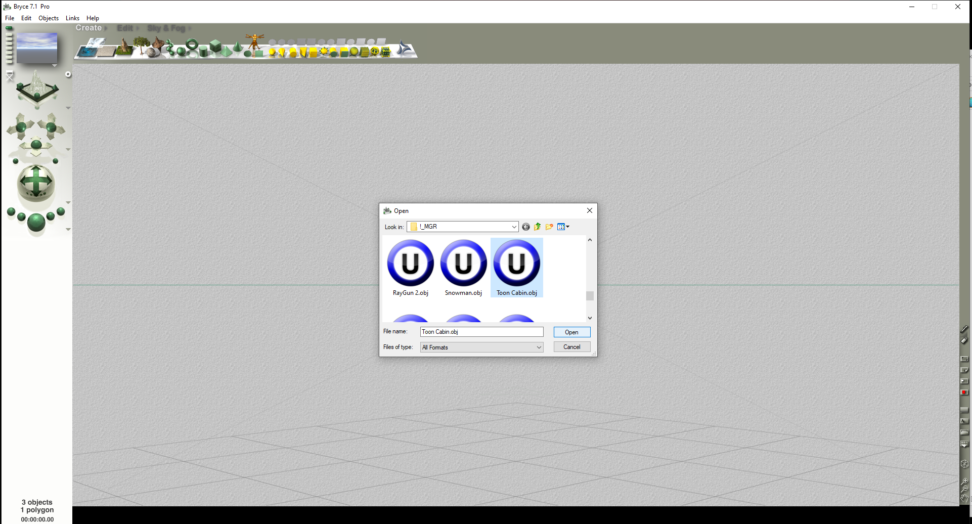

I'm new to this and don't know how to import an object along with its texture.
When I import this object together with the .mtl file, the textures do not load correctly. I think this problem is due to my lack of experience with the program. I would appreciate your help.

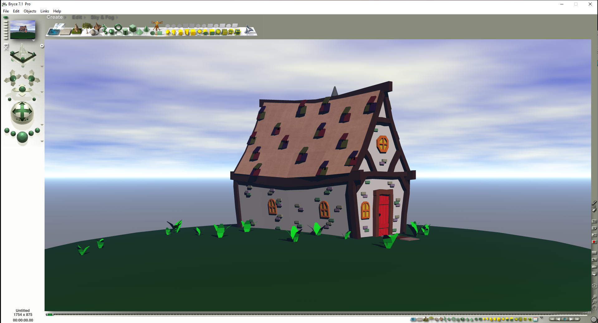

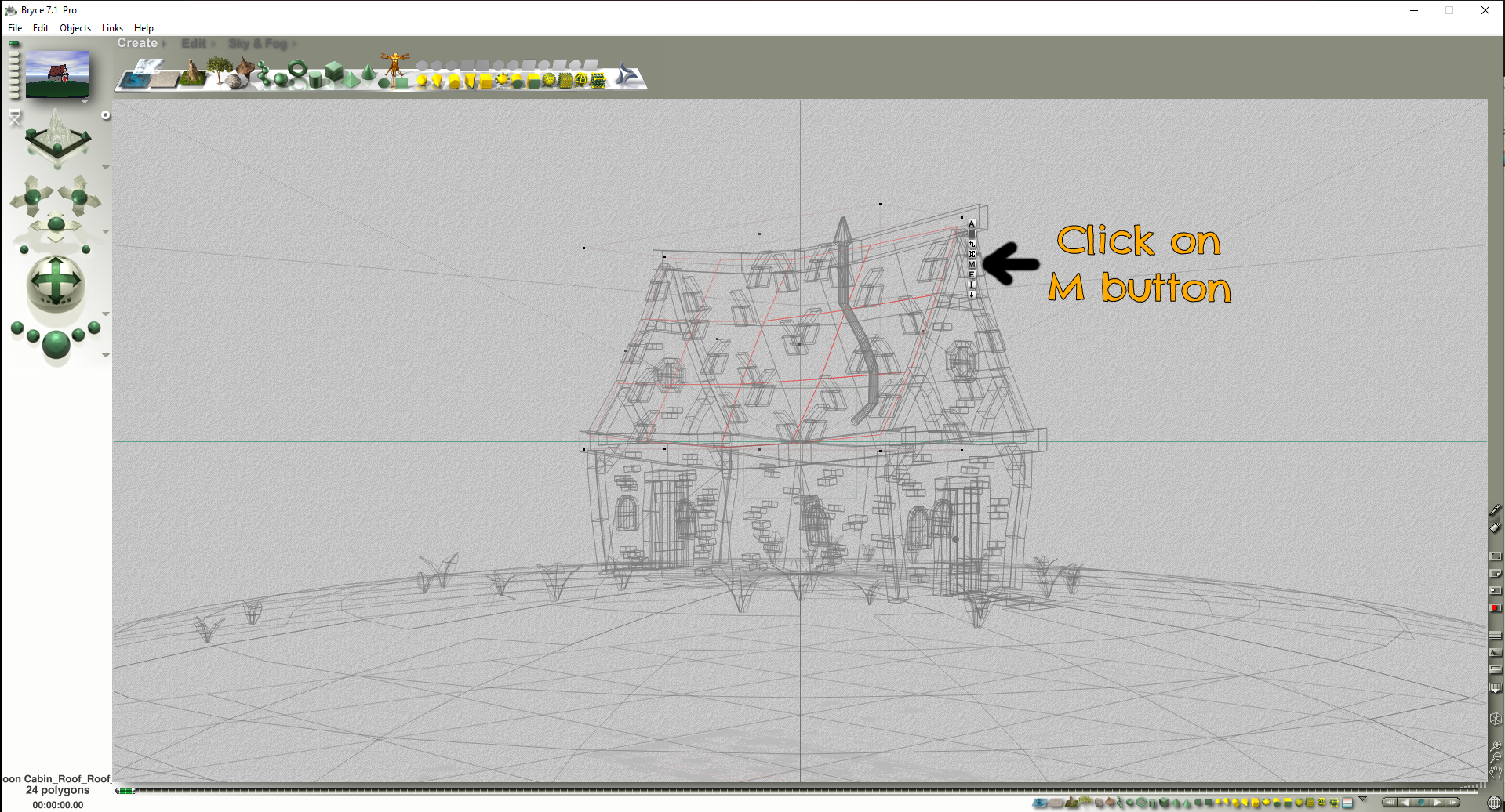

  • Bunyip02Bunyip02 Posts: 9,343
    edited August 2025
    A bit of a tutorial - hopefully Horo might chip in with a good recommendation for an advance tutorial on the subject.

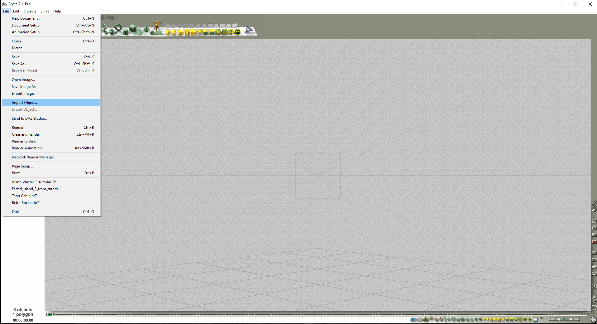

    Click on File then Import Object
    Locate obj file

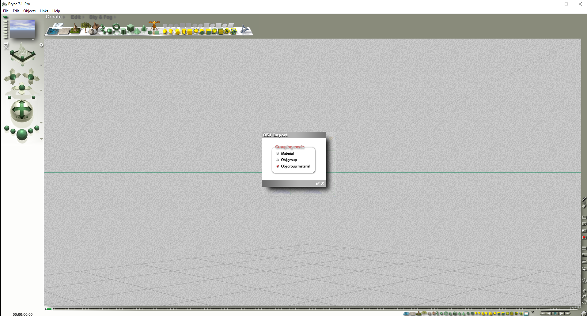

    Click on Obj group material

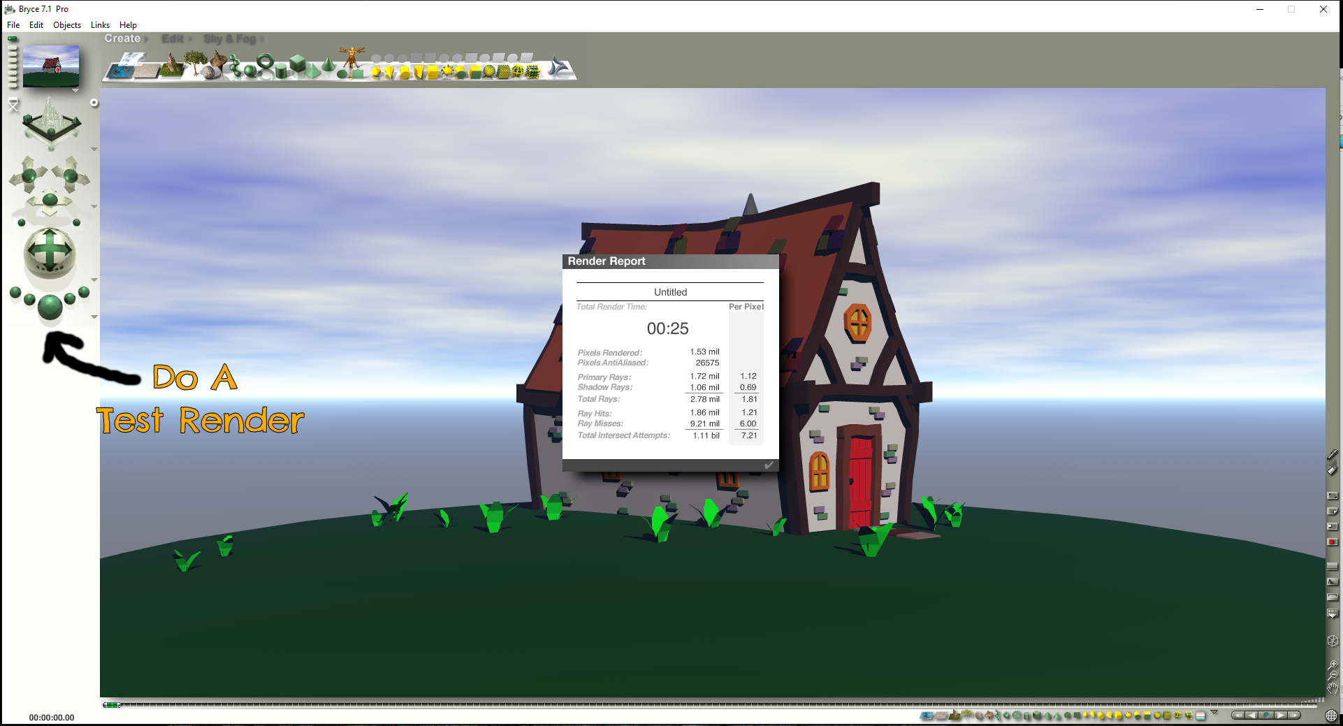

    Do a test render

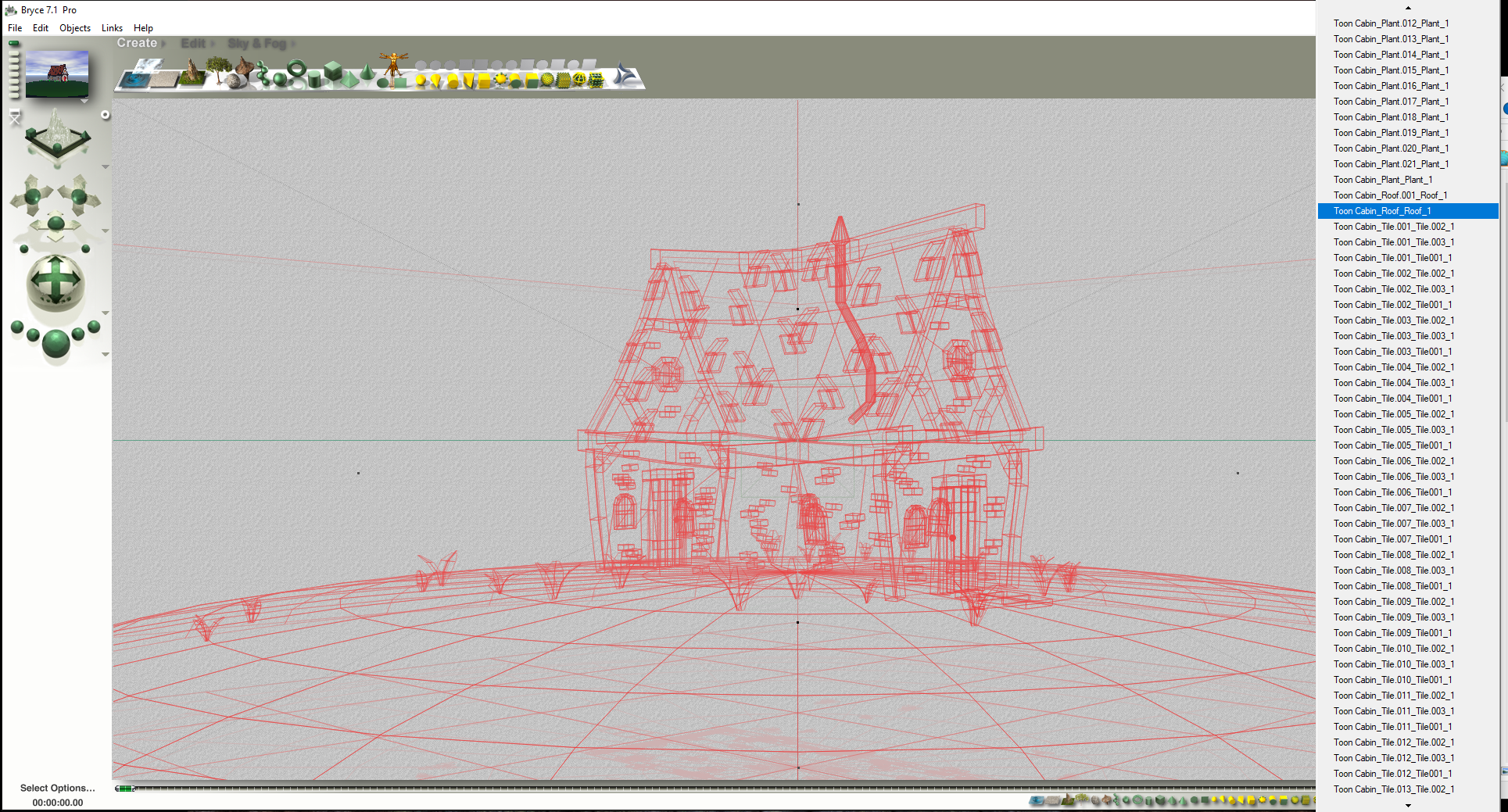

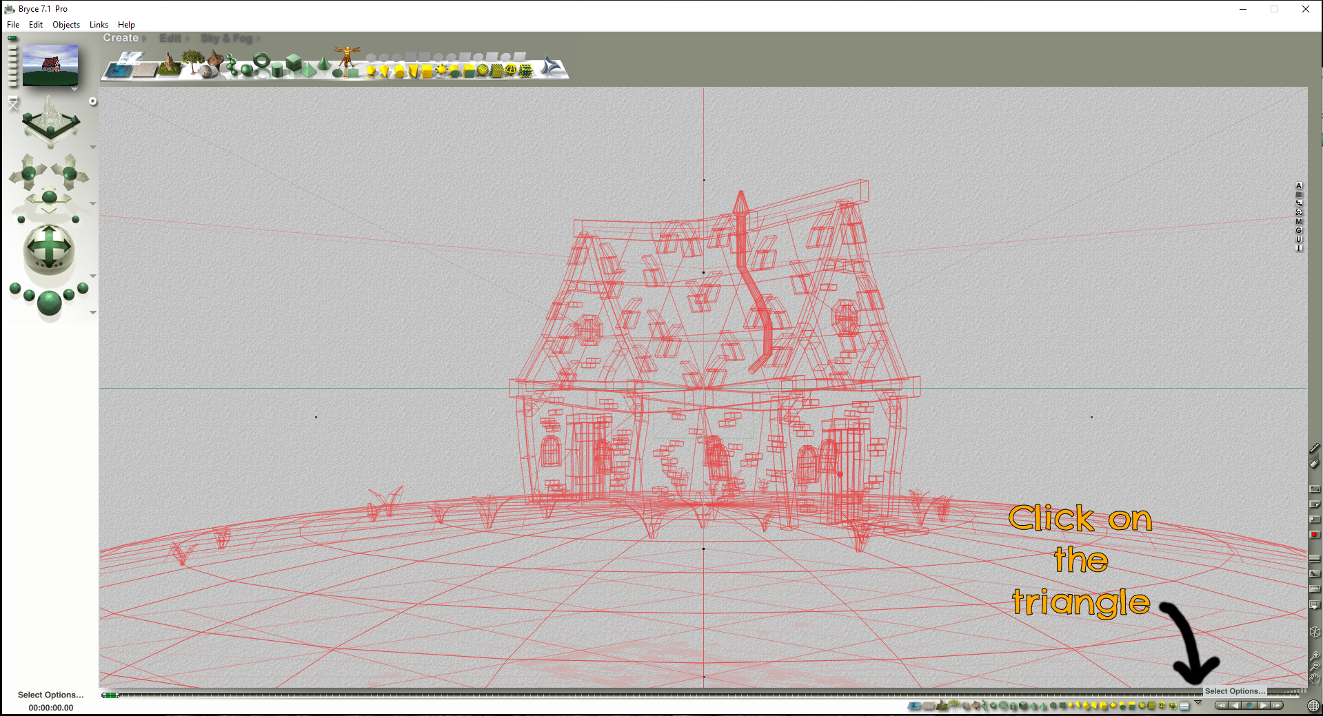

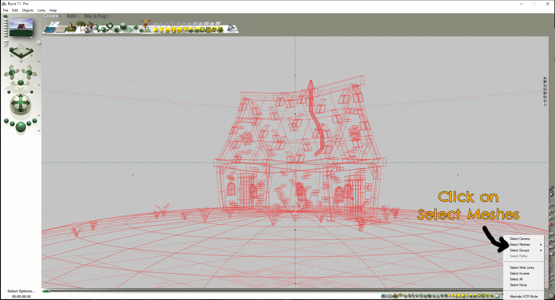

    Some objs have multiple elements, to find out, click on the triangle
    Click on Select Meshes
    Post edited by Bunyip02 on

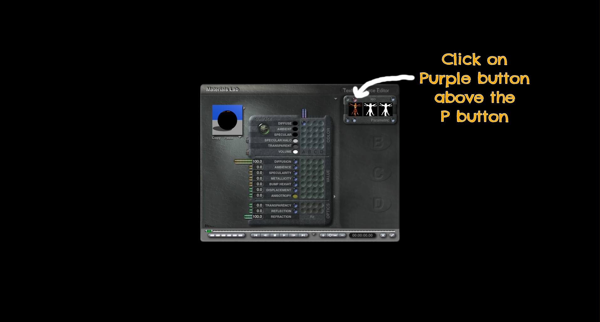

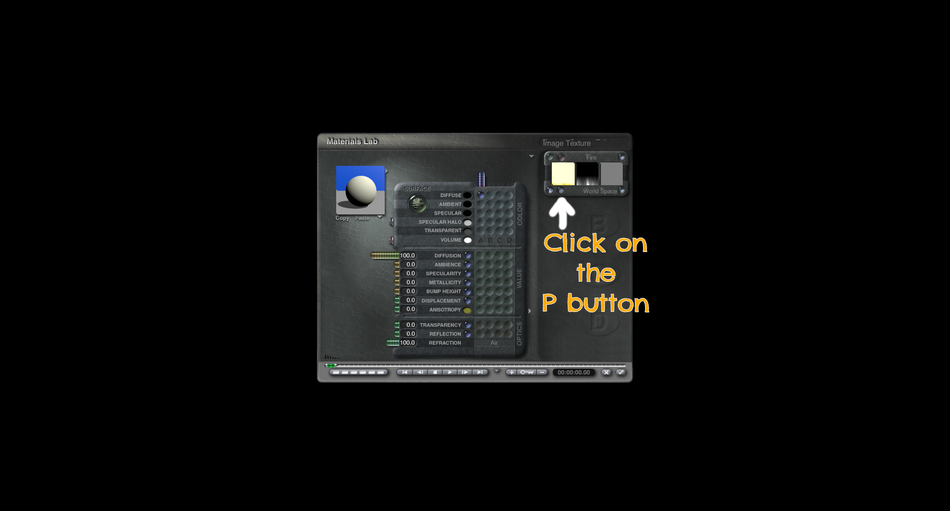

    edited August 2025
    Continuing -
    Scroll down the list to the section of choice, click on it to select
    Check that the area selected has turned red. Next click on the M button

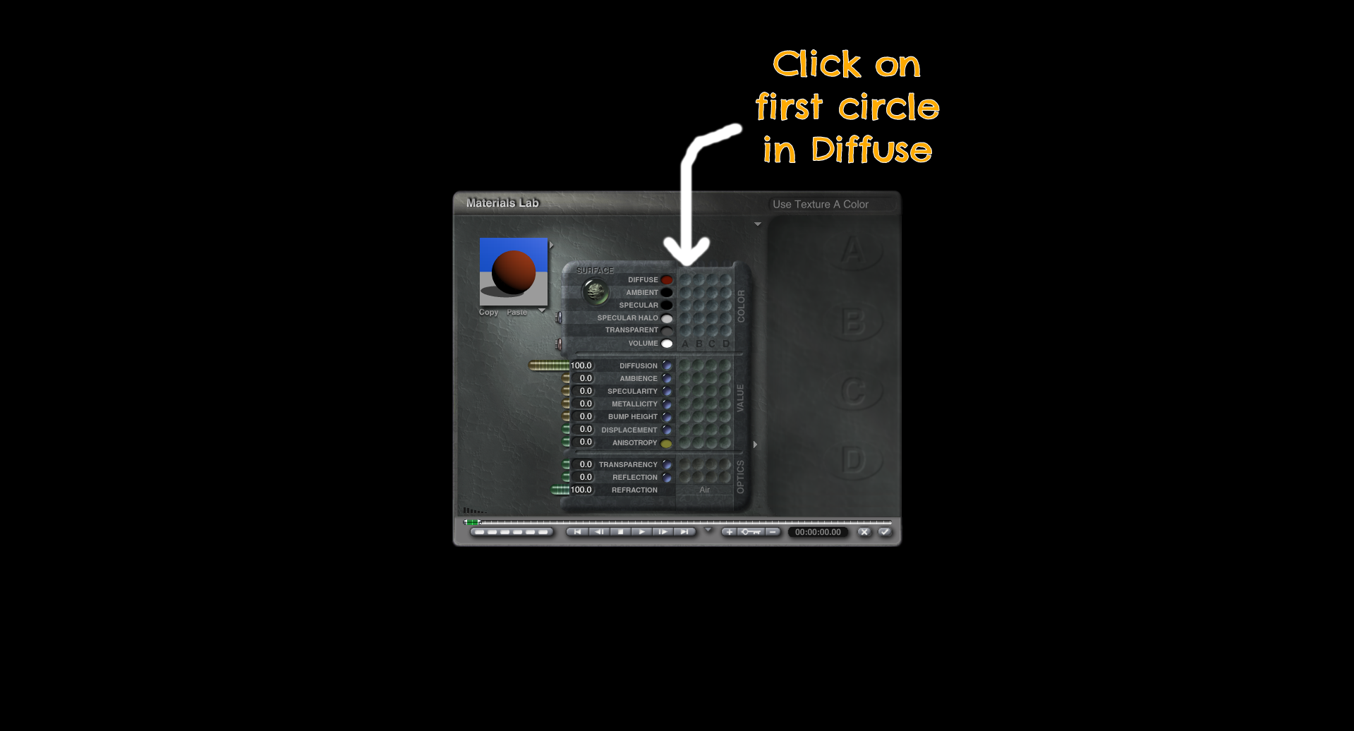

    If it did not load with textures, click on the first circle in the Diffuse row
    Click on the P button
    Click on Purple button above the P button

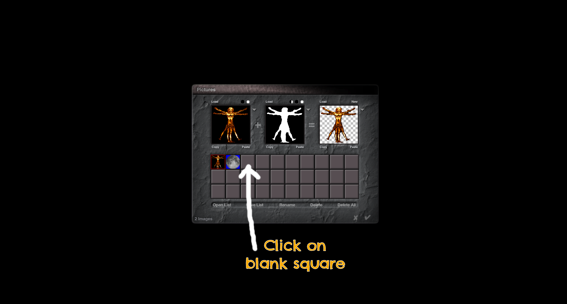

    Click on blank square next to the images to begin loading a texture

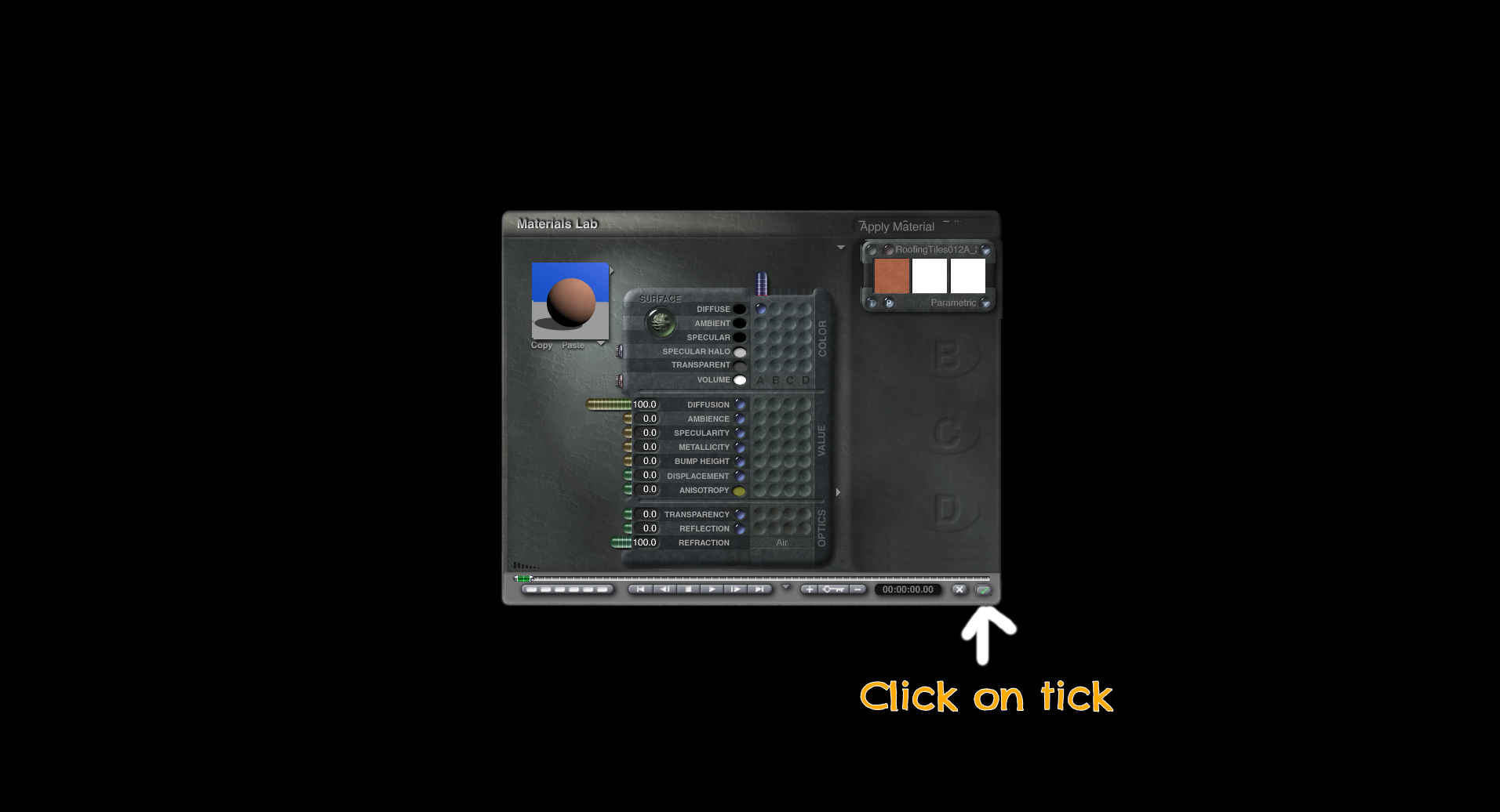

    edited August 2025

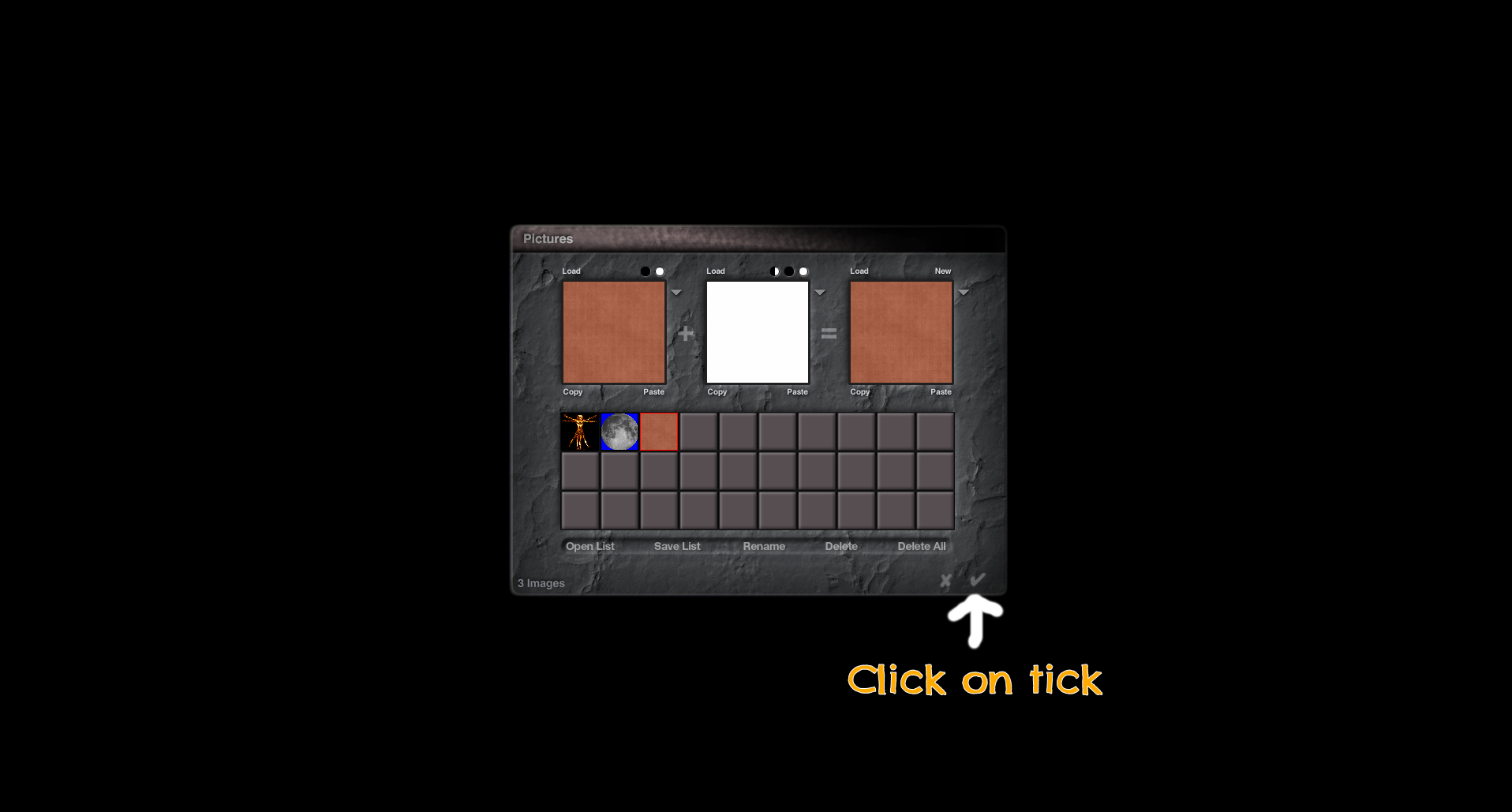

    Continuing -
    Locate your texture file
    Click on tick to accept
    Do a test render to see how the change looks

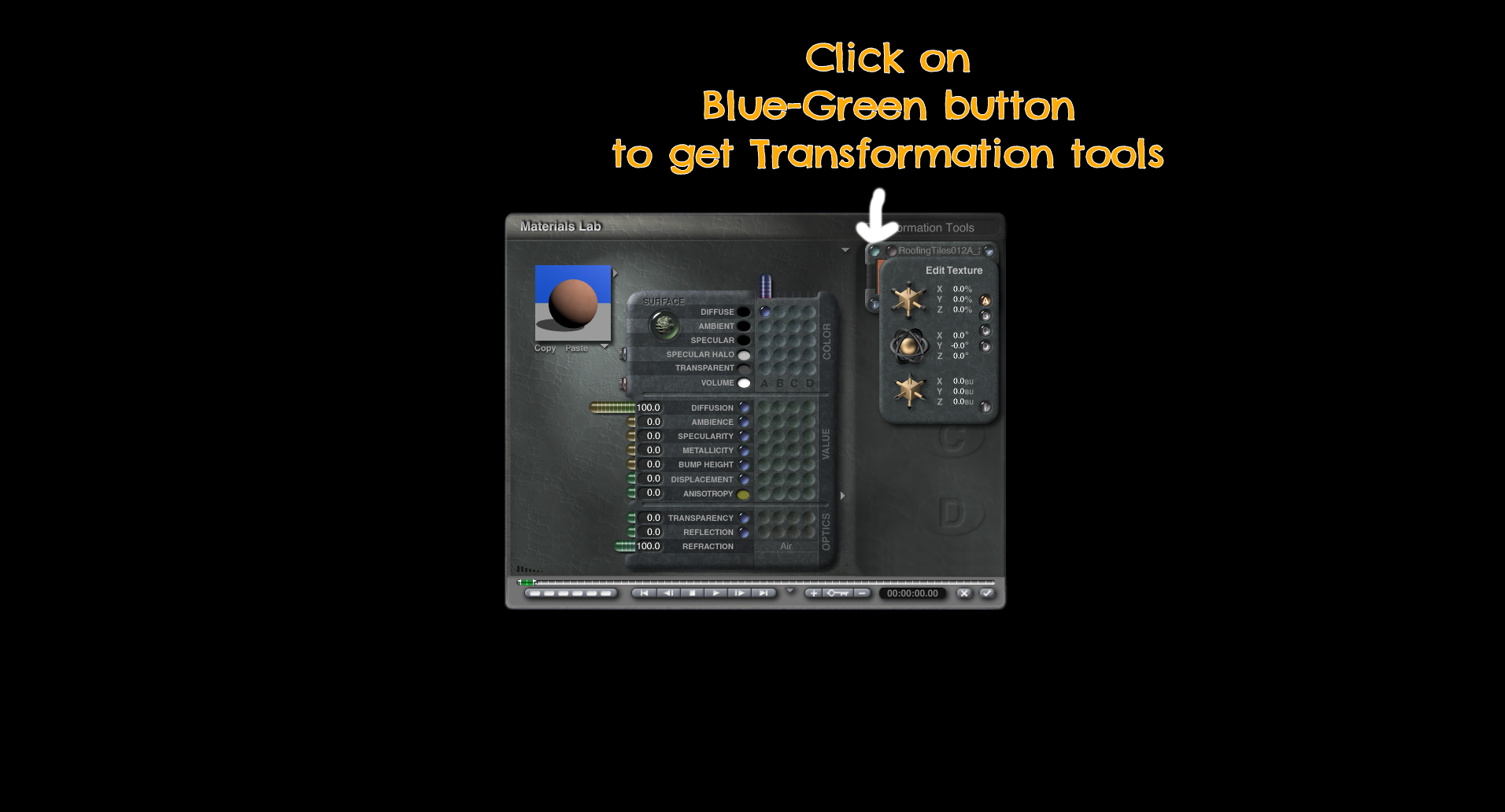

    If you go and click on the M button again, then click on the Blue-Green button you get the Transformation tools.
