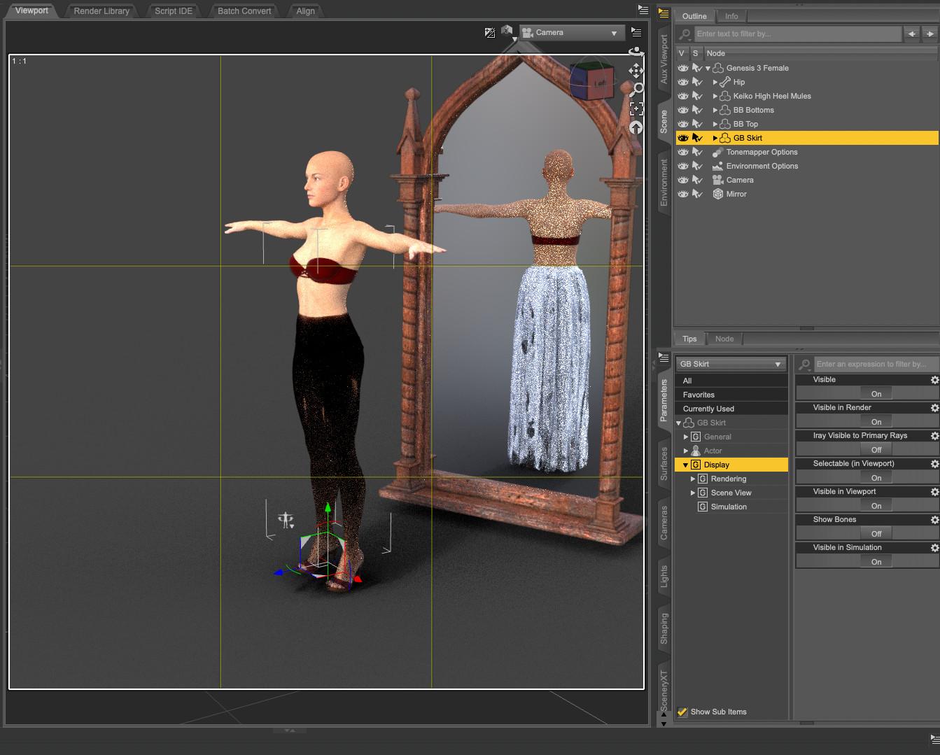

    I don't know if it'll done exactly what you want, but you can try to use the 'Create Advanced Iray Node Properties' to add 'Iray Visible to Primary Rays', then set it to Off on anything you don't want to see: they should disappear but their shadows and reflection will still be visible.
    Two examples.
    1. Iray Visible to Primary Rays is set to Off on G3F but her reflection and shadows are still rendered:
    2. This time, Iray Visible to Primary Rays is set to On on G3F but Off on the Ghost Bride Skirt. The skirt is casting shadows on G3F's legs, on the ground and its reflection is visible in the mirror:

    It's something you have to add through a script provided by Daz. The
    In your Content Library, go to the Scripts/Utilities folder and you should see a 'Create Advanced Iray Node Properties' script (without any thumbnail). Launch it with the items you want to make invisible and check 'Iray Visible to Primary Rays' (I think you'll have to check it for all items selected).
