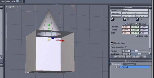

Is WELD the correct command to use when makinga composite shape from two or more primitives? Example: rectangular primitive with various spikes made from cone primitives inserted all over it's surfaces. Say 1 rectangle, 15 cones inserted. Select all and click weld. Does that operation remove all the unseen polygons and parts and make it a contiguous whole with nothing "hiding" on the inside that has to be computed somewhere down the line?
    In a word, no. Try it yourself. I created a cube primitive, stuck a cone into it and used the Weld tool from Vertex Modelling. The result is shown below. You would need to use a different method, lining up points and target welding them I think.

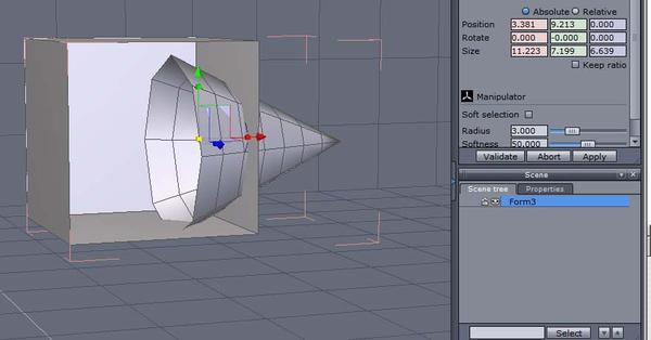

    Thanks for the quick reply JimmyC_2009 - I thought I was approaching it wrong but wanted to verify - it just seems sooooo easy to do it that way. Is it preferable to NOT combine primitives then and, for the example project I mentioned, work with a single rectangle primitive ONLY, and manipulate surface polygons into the shapes I want (in this case spikes at random sizes, shapes and spacing)? Or, sliding the primitives together and as you suggest, wlding (target) points togother and deleting the parts that don't fit when your done (the hidden parts)?
    A Boolean Union would do what you want to do easily, but it leaves very messy geometry at times, and I seldom ever use them. It works great for one cone (see image), but for several it may make a complete mess. Box modelling would probably be the easiest way to make a clean mesh, using extrude surface tools.
