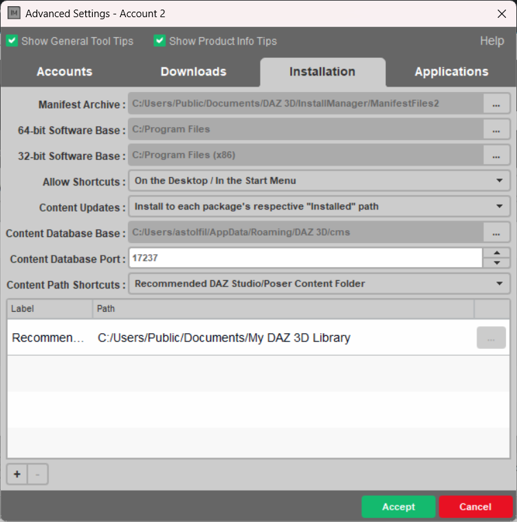

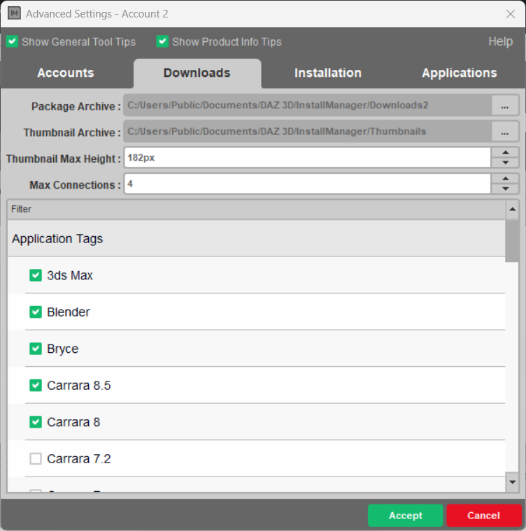

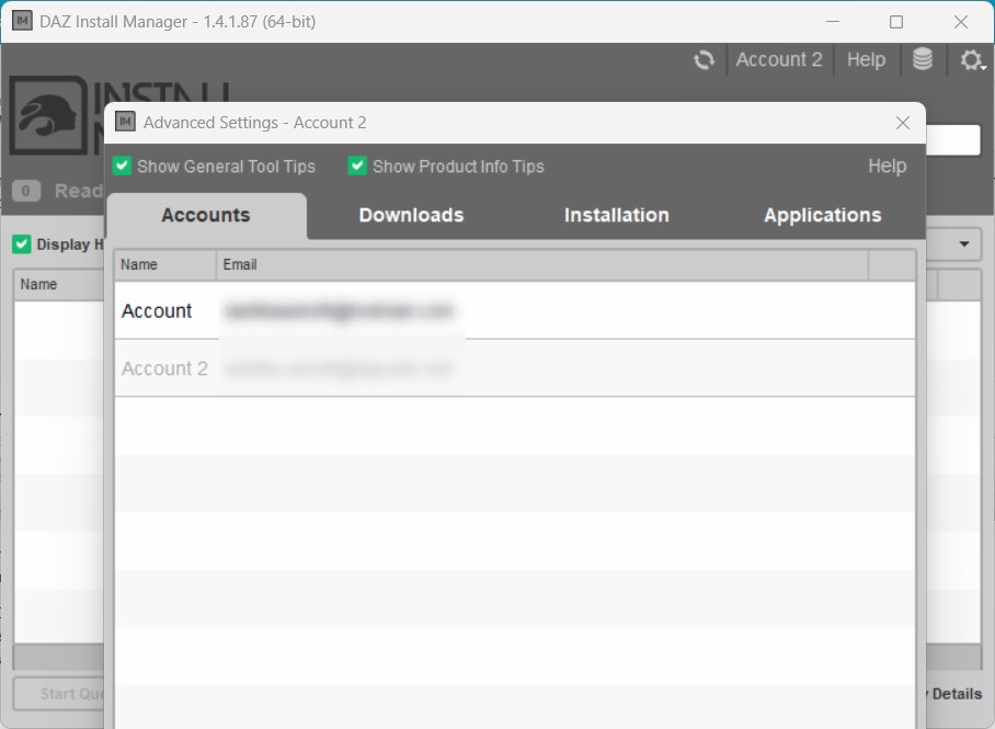

    It likely wouldn't work with Connect install, but that should be doable with DIM as you can define multiple acounts there.
    I would suggest defining different Downloads and Manifest folders for each account in DIM so that it doesn't risk getting confused regarding what's installed:
    1. Add account 1 and 2 in DIM with the drop-down in launch window, without logging in to any of them
    2. select account 2 in the list, then tick "work offline" and go to "advanced" parameters
    3. go to "Dowloads" tab and change the path to "Package archive" to another folder (eg I created a "downloads2" folder next to the original one), and same for thumbnails if you dowload them.
    4. do the same for "Manifest Archive" in Install tab
    5. Accept the changes

    Thanks Leana. Using DIM I seem to be able to do what I want following your suggestions.
