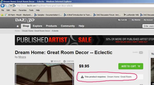

That message means that you are trying to load a texture for an item which is not already loaded into the scene. Load the figure item first, and then use that file to change the material on the already loaded figure.
There is a series of "Eclectic" textures for various DreamHome items. They are textures only and you must have the corresponding item. Check the product page you ordered from. It will state the required item
Well spotted Medzin, I had forgotten that Ecectic are just texture sets.

You must always check the Product page for any required products as Medzin says, there are a lot of extra texture sets for some itmes, but you need to purchase the main item as well. If these are no use to you, you can ask Support for a refund.
