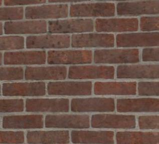

I have a $1.99 brick wall.
When I render at a closer range (not THAT close) it looks extra-ordinarily flat. Like 3D Doom brick wall incarnate.
I tried some shaders (which I know a little about) but of course that replaced the wall with shader brick. Not what I'm looking to do this time around.
I admit I have never played with this area of DAZ and after a brief Google adventure have a basic concept in my head of what I'm actually looking at.
So back to my brick wall.
How can I give it some grit/roughness/some 3d?
Is there a basic, basic, basic step guide/tutorial out there some where that will help my cheap wall (or similar object)?
Thanks!

    Okay first lets say you have a flat brick wall texture. The Bump and Displacement settings are in the Surfaces Tab when you have the Wall selected in the Scene Tab or Viewport. Here is my Brick wall from Daz with the Surface Settings for it.
    Awesome start, thank you so much.
    My brick wall has bump maps but no displacement maps.
    Is that a problem?
    Can I use the bump maps as a displacement map?
    Or do I have to make a displacement map?
    And if so... how? :)
    Edit: I see your second post now... so yes... how? :) :)

    Nope, Just open the Displacement section and PICK the bump map to load (load the same file name). Then play with the settings for Displacement. Do some Spot renders until you get the settings you like. Note, High settings can cause the edges to not line up so test the Top or bottom that will be in your render.

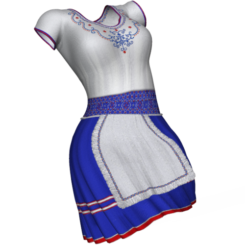

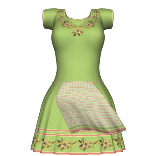

    edited September 2012
    And displacement done from a bump map is never so good as using a purpose built displacement map, especially in DS, as this reads medium grey as level, lighter shdes come out, or upwards and darker shades go downwards, so you get two way displacment to look more rlealistic.
    A lot of people have a habit of makingg bump maps merely by desaturating the texture map, and this is not optimum for bumps, and certainly would make a lousy displacement map.
    Edited to add a couple of images to show how a dispacment map works, forst is just the displacement applied to an untextured dress, and 2nd is how it looks with the texture. 3rd shows without the map
    600 x 600 - 292K
    600 x 600 - 282K
    600 x 600 - 199K
    Post edited by Chohole on
