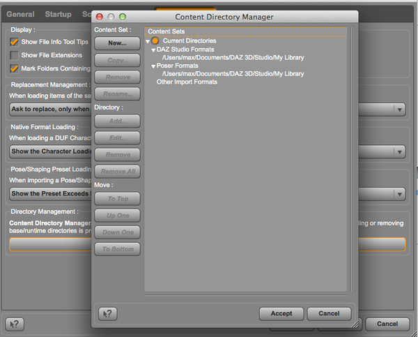

    Where are you installing the Genesis Starter Essentials (exact path), and what does DS show under "Edit > Preferences > Content Library > Content Directory Manager" with the DS formats and Poser formats expanded?
  • MaxHancockMaxHancock Posts: 227
    um... you are an admin?
    My content manager paths seem to be correct...(see attached image).
    I installed only to the default path, as seen in the image of my previous post.
