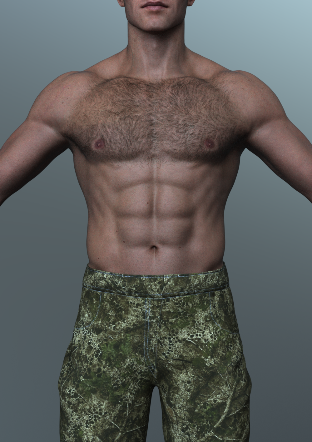

I have Jepe's dForce Omni Body Hair Sets & Omni dForce Body Hair Sets Part 2. I think they are great products, but I don't use them much for one specific reason. Depending on the texture, the chest hair has this negative ring around. If the texture doesn't fill the area perfectly, parts of it are symmetrically barren.
I know nothing about dForce and OMNI hair. If I want to edit any other product, I could use go into the GEOMETRY EDITOR and delete faces/vertices/etc. However, I can't do that with OMNI hair.
Suggestions? Options?
Thanks in advance.
644 x 910 - 439K

    Third, strand-based hair is not "geometry" in the sense that DS understands it, which is why you can't manipulate it with the Geometry Editor. If you created the SBH itself, you can edit it with the strand-based hair editor, but not so with "dForce" hair from the store. Luckily, there are still some options available to you. SBH can be manipulated extensively through the use of greyscale maps, governing things like density, length, frizz, clumping etc. On the above example (if, again, you're just talking about the bald spots where nipples should be), you could find the density map and just color in those areas with white, or whatever level of grey matches the amount of hair you want to be there.

    Depending on the texture, there will be an area where no hair appears on the skin in general. I can expand out the areola, but then the character will just have cartoonishly large nipples. If you look at this render of Julian, there is a "symmetrically barren" area (as I put it in my original post) where hair should clearly be. Its far too uniformed to be natural looking. Now that I know its a simple mask (black/white map), I can adjust it accordingly.
    999 x 1414 - 2M

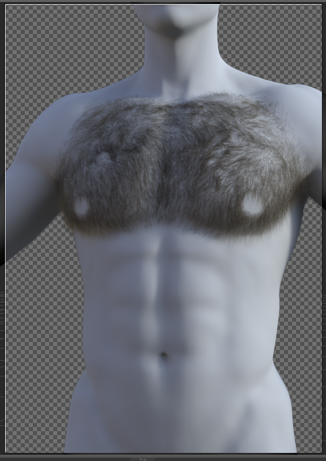

    Instead of editing the hair or nipples, you can consider creating a new groom to fill in the blanks by using the SBH Editor in Daz Studio. This applies for other SBH that may have an area you want to fill.
    If you are familiar with the process I suspect it would only take a few minutes. But if you are not, there could be some learning involved.
    I uploaded an example i made in like 3 minutes.  It's by no means good
    https://drive.google.com/file/d/152uKYE0zu5a8uMghyG_9U455f334J4dR/view?usp=sharing
    It's just a scene file duf, so you can merge with your scene and then "fit to G9" in parameters (unparented). May need to toggle off and on the aapply transforms button.  To edit the groom further, you can select and go to Edit > Object > Edit Strand-Based Hair
    Also, please change interpolation segment length to something better than i set it to.  It should be a low number ideally.
    914 x 697 - 70K
    As always, you're so kind @uncannyvalet! Thank you for taking the time out to make this for me. I really appreciate it!
