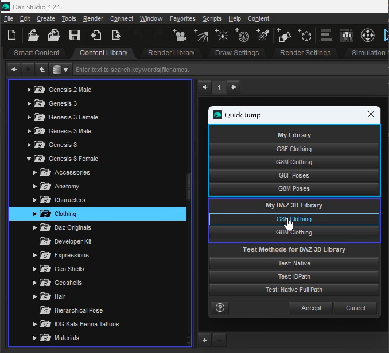

  • OmnifluxOmniflux Posts: 442
    edited June 2025
    Attaching an animated gif did not work, but here is a screen capture of using your script
    Post edited by Omniflux on

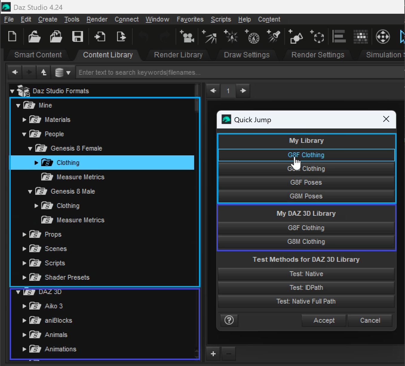

  • MaX PupkinMaX Pupkin Posts: 49
    Buddy, I'd be happy if it worked correctly, but the script moves exclusively within the "My Library" library. Check out the paths for yourself.
    I have renamed my libraries, so
    First set of buttons work with the first library (libIndex 0 in scripts PATH_GROUPS)
    Second set of buttons work with the second library (libIndex 1 in scripts PATH_GROUPS)
    Previously posted screen capture shows buttons jumping to expected folders in the Content Library pane.
    Not sure what you mean here, the screen capture clearly shows the script switching between libraries; what paths am I supposed to be checking for myself?

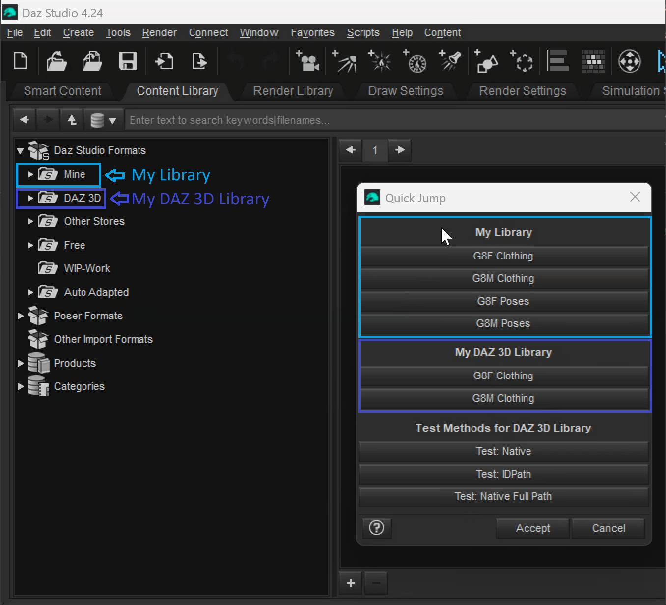

    Hi! Where exactly should I rename the libraries to avoid breaking anything?
    Rename the folder, then re-add it in the Content Directory Manager
